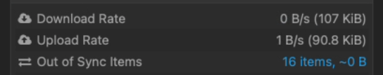

I tried many things.
First, I nullified the out-of-sync files, but that did not help - it just got 121 files, 0 B
I then removed all those files, and got a new situation with only 16 files, 0 B
I noticed that apparently, Syncthing expected those 16 empty files to exist, but they did not exist - so I used touch to create them locally. (BTW, in the list of out-of-sync files, not 16 but only 10!)
But after a Rescan, the situation was still the same: Syncing (95%, 0B) And the same list of 10 files shown when clicking on the 16 out-of-sync items.
I then Paused and Unpaused the Remote Device (locally), to avail.
No now, I have 16 out-of-sync items that show up as 10 files and I cannot do nothing with them.
I created them locally, with 0 bytes, as expected but no change.
I see no option anymore!
I don’t care what the remote side thinks or expects - I just need a way to push the local data or to overrule the remote side (strange) ideas and expectations.
What can I do?
