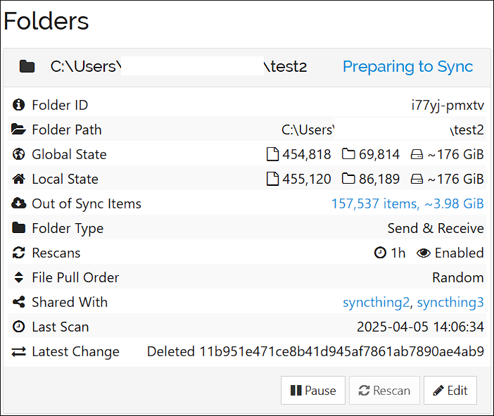

In the meantime, I’ve also observed that for some reason it takes extremely long time to rename directories and sync changes after doing so. For example, I’ve got a three device (instance) setup. Two of them run Syncthing v2 (beta5) and the last one runs Syncthing v1. On the first of the v2 instances, I renamed a directory containing 97,019 files and 16,374 directories. The rename synced to the last instance running Syncthing v1 in about an hour.

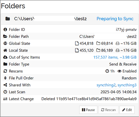

The problem is that when it comes to the other instance running Syncthing v2, after the same amount of time, the sync is still in progress, and it is moving extremely slowly.
This is what the current state looks like:
The number of “Out of Sync Items” does keep decreasing, but it seems to happen in bursts, decreasing only by a few hundred items per minute. At this pace, it looks like the process is going to take days to finish :confused:.
This is all tested on very fast hardware, so there’re no other bottlenecks in place.
Edit 1
The number of “Out of Sync Items” has decreased by 20,000 from 157,000 to 137,000 in 3 hours time, so if the estimation is correct, the sync is going to take ~20 hours to finish. This is just a test set of data, so I’m cancelling the whole thing now. I’ll try to reproduce the issue with a smaller set, possibly without any private filenames, so that I can share the logs too.

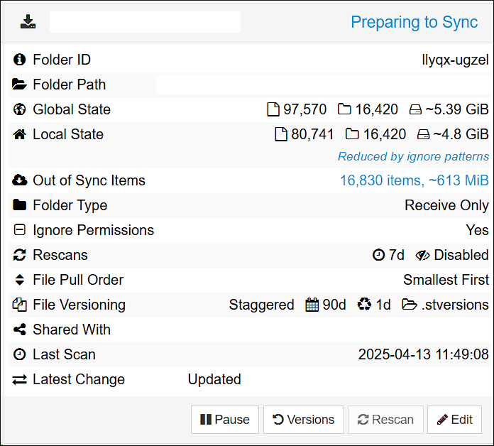

I’m experiencing a problem that began when trying to revert local changes in a Receive Only folder. The case was similar to what I already experienced before in https://forum.syncthing.net/t/syncthing-on-sqlite-help-test/23981/184. Basically, it was taking forever to re-download files that have been deleted locally.
After many hours, I’ve tried to pause the folder and also pause the remote device, but Syncthing seems to be completely stuck. The GUI appears responsive on the outside, however trying to make any changes leads to an endless “Syncthing is saving changes state”.
I’ve also noticed that Syncthing has now taken 10 GB of RAM. The CPU is also doing something, but I’m not sure what, and the CPU load seems to be steady at same level, all the time.
I’m attaching CPU and heap profiles, and also a full goroutine stack dump.
  • cpu.pprof (32.7 KB)
  • heap.pprof (301.8 KB)
  • goroutine.txt (108.9 KB)
The Syncthing binary has been built from https://github.com/tomasz1986/syncthing/tree/tomasz86/releases/tomasz86-v2.0.0-beta.9.
I’d very thankful if you could have a look at the them and see if there is anything obvious in there. Otherwise, I will likely be forced to kill and restart the program :slightly_frowning_face:.
Thanks, I’ll check it out, though it may be a little while as I’m getting on a plane later today and will be in transit for a bit over a day and then on vacation. :palm_tree: I’m hoping for the 2.0 stuff to marinate in the meantime so this is awesome keep it coming :pray:
Sure, I hope you have a great time :slightly_smiling_face:.
I’ve started the migration with less important devices/instances, so it’s not that huge of a problem. This one, I could actually keep in this state if it was helpful later for further troubleshooting. Does it matter or should I just kill the process and launch Syncthing again?
If you can take a support bundle before killing it, that’s all we need. It’s essentially what you already had plus some logs and config for correlation, no need to publish it publicly if you don’t want.
I’ve just taken and saved it. I would need to obfuscate device names and paths if I was to share some of them, but I can do it if they are necessary. I’ll keep the bundle file on the disk, so just let me know if something else is needed from it.
The goroutine profile in pprof format would be nice. The CPU profile above has the things doing leveldb gets, so I think that one is from something else as well.
You’re right about the profiles, there are two instances of Syncthing running, and I’ve taken them from the wrong one :flushed:. Only the goroutine dump was correct.
I’m attaching the proper files below, taken from the support bundle. I’ve also added the few other files from the bundle that don’t require obfuscation.

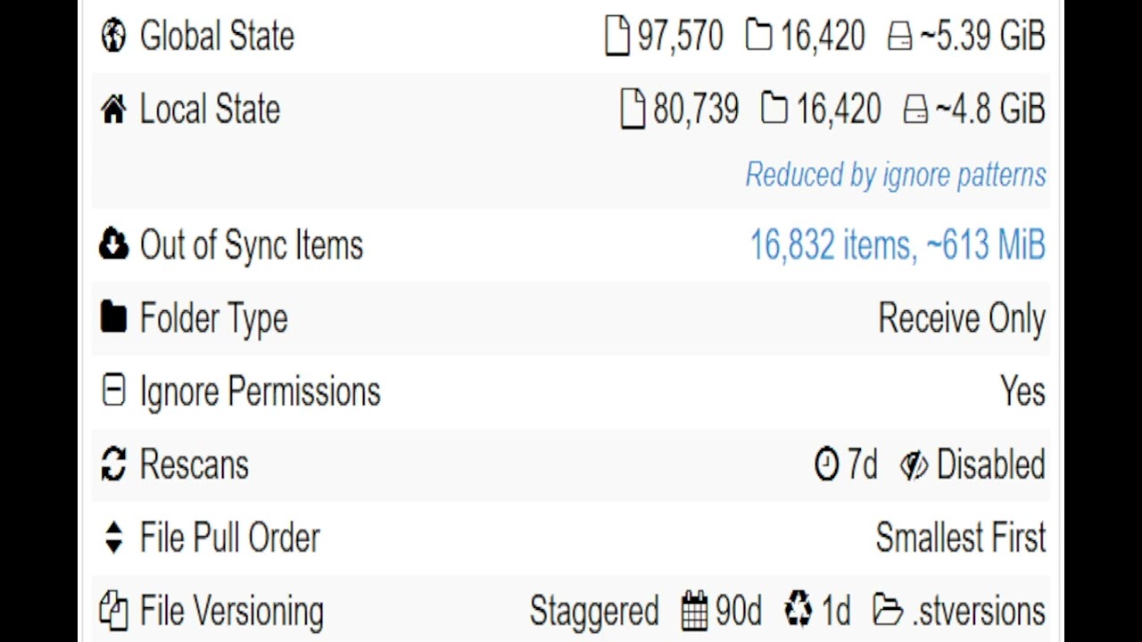

Edit:
Just to show the main issue:
This is in real time, so basically 2 files are downloaded per minute :confused:. With this in mind, it’s actually much faster to just remove the whole folder and download everything from scratch, because there is no such slowdown when actually syncing. It seems just when local changes are reverted in this “Preparing for Sync” phase that is super slow. I was wrong, it’s also very slow when synchronising the folder from scratch. I’m going to try to reproduce this in a clean environment. I think I can also reproduce the crazy RAM usage, as after leaving the folder in this state alone for a while, it’s again at 12+ GB.
Just in case, I’m uploading yet another set of support bundle files. The previous one was after breaking the folder reverting changes and the connection. This one is still from when the folder is in the very slow “Preparing for Sync” state with extremely high RAM usage.
