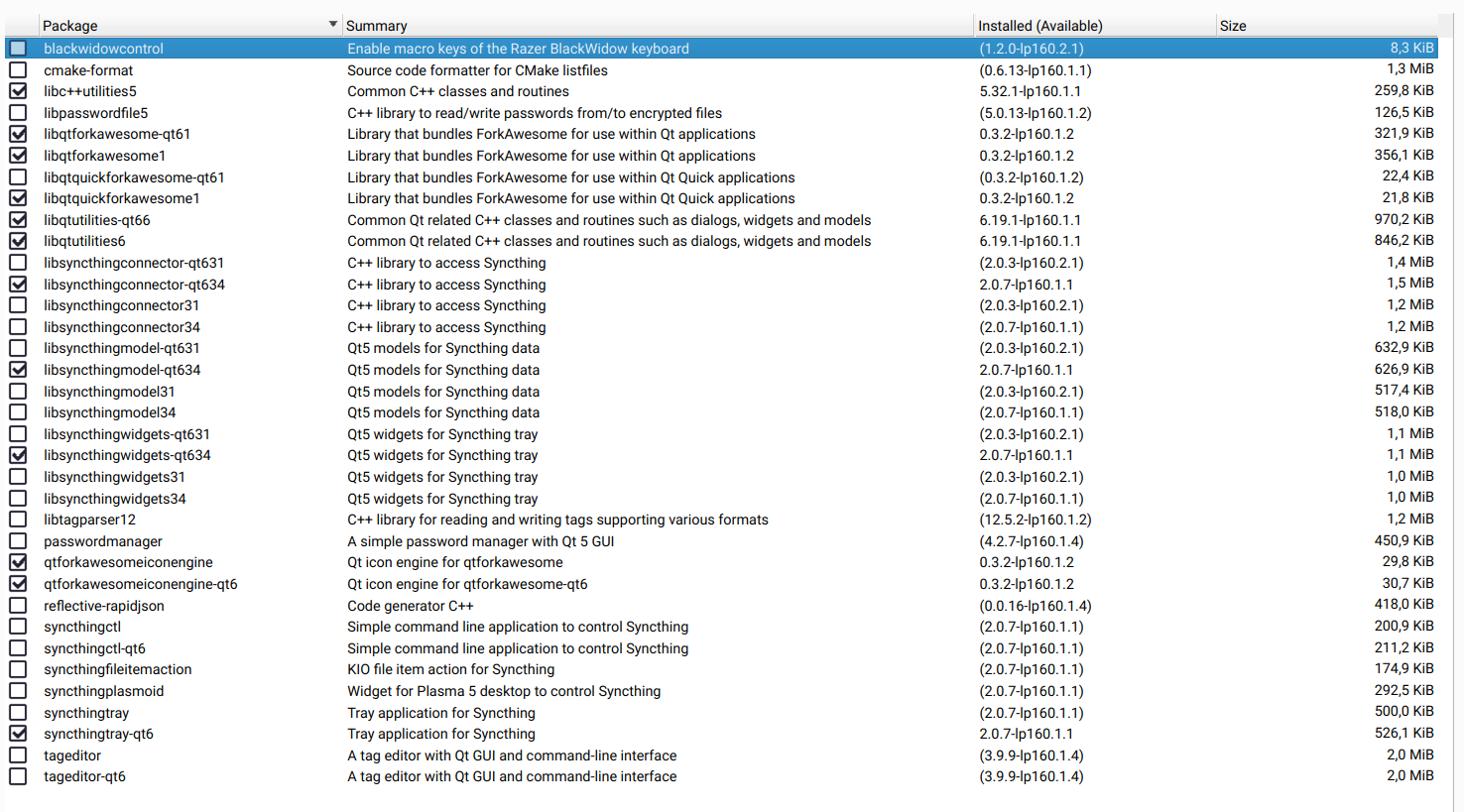

Here’s a screenshot of the packages that Myrlyn shows as available:
The packages I mentioned before are only available as their Qt 5 versions and the plasmoid never shows up.

Oh, right - you’re talking about KDE integrations specifically. I’ve now enabled them in the VCS sub project (see Show home:mkittler:vcs / syncthingtray-qt6 - openSUSE Build Service ) and if it builds I’ll enable them also in the regular project. Unfortunately OBS decided to block the build/scheduling on some other packages even though I haven’t changed those. So we’ll have to wait…
