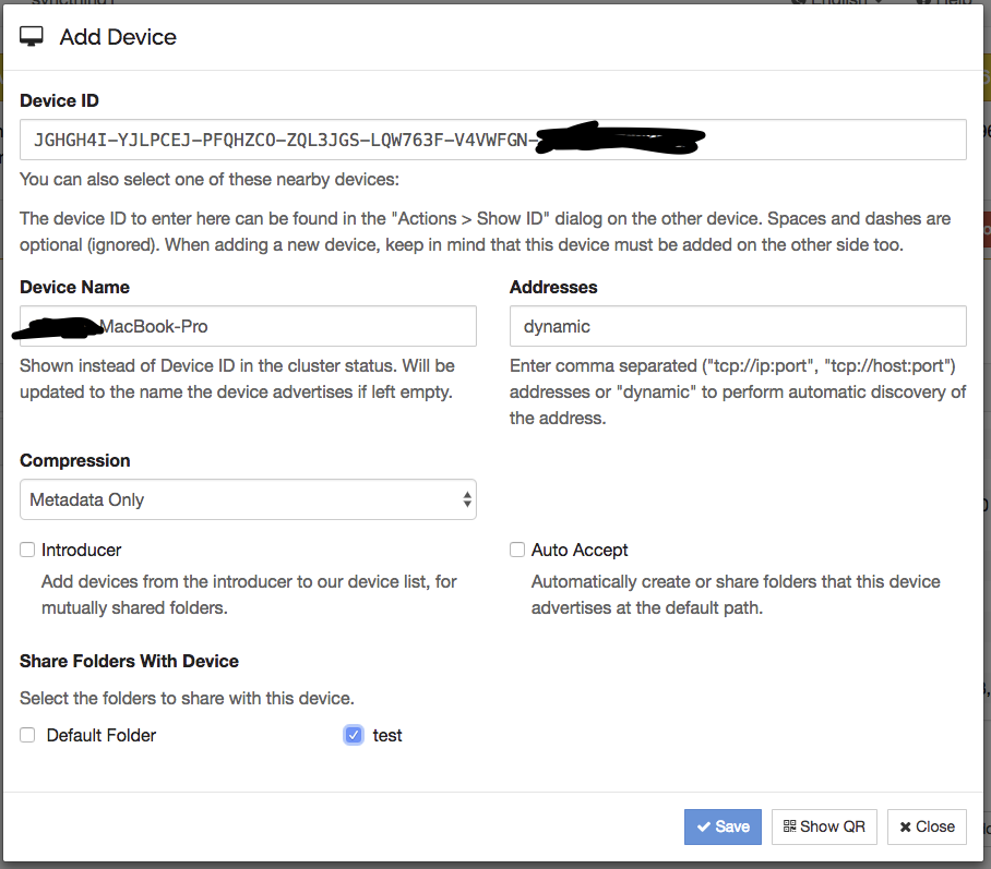

I had a thought about the test folder. It was working until I introduce the second server (i.e. 3rd device)
I.e had server 1 setup, and the local device connected with non-introducer, and auto accept shares set to true. Then I created the second server, and connected it to server 1 with introducer true and auto accept shares to true. At some point after this, my local device would not start. I cant remember if I had to manually add my local device to server 2 (or visa versa). I remember a popup in the app asking if I wanted to accept the second server. So perpas the issue is with 3 devices: two servers auto accepting each others shares, and the device accepting servers shares.
COULD IT BE THAT SERVER 1 AND SERVER 2 ARE TRYING TO ADD THE “TEST” SHARE TO THE DEVICE?
It should be ok, as they have the same ID. I suggest you disable these auto-introduction stuff, and add folders manually.
Do we think that the “Auto Accept” feature is broken in a 3 device scenario? It would have been ideal for us.
The difficulty will be educating our users that they should not tick this box (which will break the client and is difficult for users to fix), but instead manually share each folder.
This what I did on the server.
I cant show the client UI as I cant start it, but on the client I ticked auto accept. also, I did auto-accept between server 1 and server 2, so that adding a folder to server 1 would automatically put it on the back up server 2.
Well try undoing it and see if it makes it better. Perhaps there is a bug, but until we know whats the cause.
