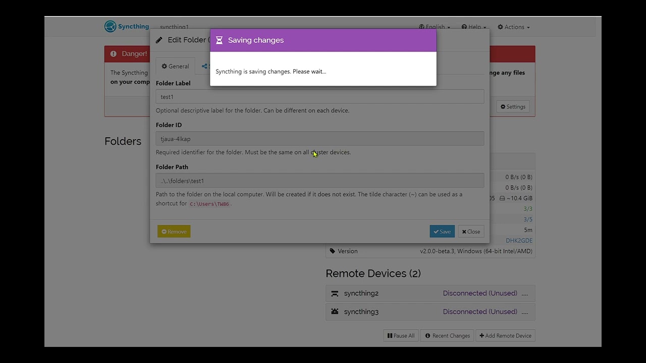

Odd, I don’t see it blocked, and it’s in code that haven’t changed radically due to the database switch… :person_shrugging: There is some potential to improve the context handling there though, but for a followup PR rather than in this one I think. To be sure, this doesn’t happen under the same circumstances with the current db?
Yeah, just tested with the old database. Removing the folder is instant there. With the new one, it can take up to 30s. Just to be clear, I’m talking about removing it while scanning is still going on.
Yeah, that doesn’t happen for me. I add a folder, let it get through the first phase of scanning so it starts showing a percentage, let it run a little while, then remove the folder. The “saving changes” dialog pops up for a second or two, then goes away, the folder is removed, the logs say “failed initial scan of $folderid” (which is expected).
I think the problem gets more pronounced the further you are into scanning, e.g. here with the test folder:
if I remove the folder at the very beginning of a scan, the wait time is very short, however if I do it once scanning has reached 50% or higher, then it takes much, much longer. This isn’t the case with the old database.
Yeah I don’t disbelieve you, but this is how it is for me.
Maybe it’s something specific to Windows?
This is what the same process looks like here :frowning:.
The delay is visible in the log as well:
[DHK2G] 2025/03/16 21:48:11.411898 svcutil.go:163: DEBUG: serviceMap[string, <nil>]@0xc000285cb0: Service sendreceive/tjaua-4lkap@0xc000780008 failed to terminate in a timely manner
[DHK2G] 2025/03/16 21:48:51.753476 folder.go:497: DEBUG: sendreceive/tjaua-4lkap@0xc000780008 finished scanning, detected 77801 changes
[DHK2G] 2025/03/16 21:48:51.753476 folder.go:936: INFO: Failed initial scan of sendreceive folder "test1" (tjaua-4lkap)
[DHK2G] 2025/03/16 21:48:51.753476 folder.go:314: DEBUG: sendreceive/tjaua-4lkap@0xc000780008 next rescan in 54m10.327242425s
[DHK2G] 2025/03/16 21:48:51.753976 folder.go:184: DEBUG: sendreceive/tjaua-4lkap@0xc000780008 exiting
Yeah, I found the issue, my bad. It’s not Windows. The last part of the scan wasn’t cancelled properly after my database changes. (wip · calmh/syncthing@be645b1 · GitHub)
