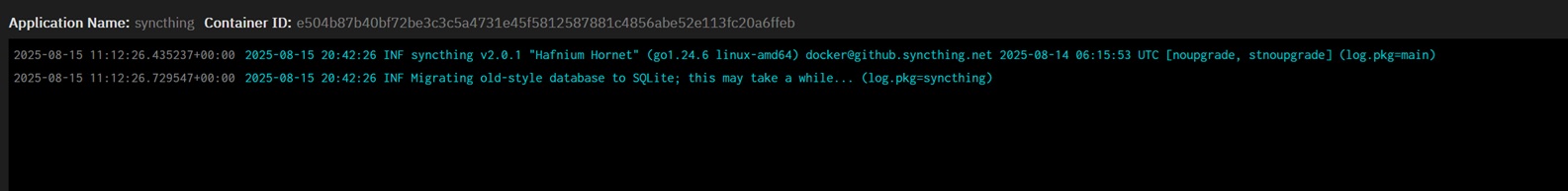

As for logs from syncthing: the migration is reported as running (ref logs here), but no new messages keep being logged, which in turn means the migration is not running at all.
