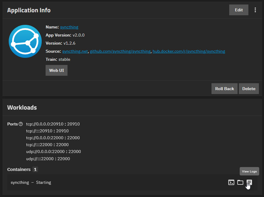

To start off “1.2.6” is a version number which is specific to the TrueNAS App Catalog, not Syncthing. If you’re downloading from the Stable train, the version of Syncthing you’ve installed is very likely to be 2.0.

You can monitor the migration’s progress if you look at the Container Logs:
The logs should say something like this to start:
2025-08-12 15:23:25.030129+00:002025-08-12 10:23:25 INF syncthing v2.0.0 “Hafnium Hornet” (go1.24.6 linux-amd64) docker@github.syncthing.net 2025-08-11 20:16:10 UTC [noupgrade, stnoupgrade] (log.pkg=main)
2025-08-12 15:23:25.043946+00:002025-08-12 10:23:25 INF Archiving a copy of old config file format (path=/var/syncthing/config/config.xml.v37 log.pkg=syncthing)
2025-08-12 15:23:26.066159+00:002025-08-12 10:23:26 INF Migrating old-style database to SQLite; this may take a while… (log.pkg=syncthing)
