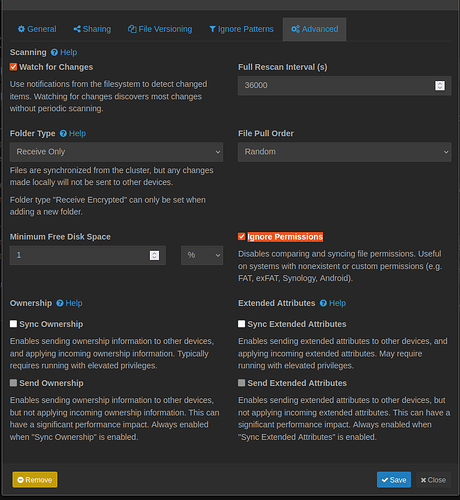

From the Syncthing gui, not Truenas. For each syncthing folder residing on the server, edit the folder, go to Advanced, and enable “Ignore Permissions”.
Otherwise syncthing doesn’t think files are ever in sync. I think I had a folder full of .tmp’s before finding this setting.

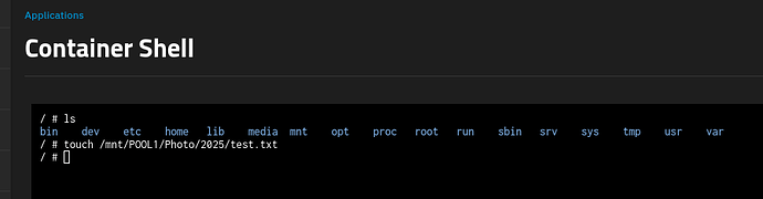

When opening a shell in the Syncthing container, I can write to the mount path configured in Syncthing (/mnt/POOL1/Photo/2025)
And the file gets written:

  4. Your previous touch /mnt/POOL1/Photo/2025/test.txt from syncthing shell is useful, but doesn’t tell the whole story because the syncthing shell is running as user ‘root’, from the perspective of the containerized app. (Which can be confirmed with whoami.)

And if you enable “Ignore Permissions” on TESTFOLDER, and rescan, does the Out of Sync change to Up to Date?
If that doesn’t fix it, try also enabling “Ignore Permissions” on the folder at the other end of the link.
If we get this syncing properly, then we’ll attack 2025 next…
Ok, setting the Ignore Permission fixed that
