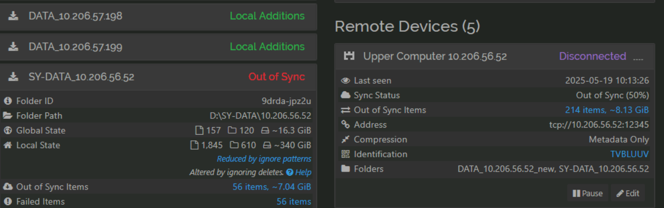

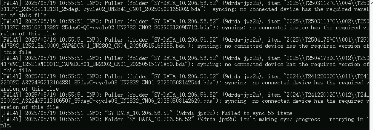

When Syncthing working normally, it was disconnected suddenly, there are some errors in cmd window as below: Could you please help me to fix this issue?

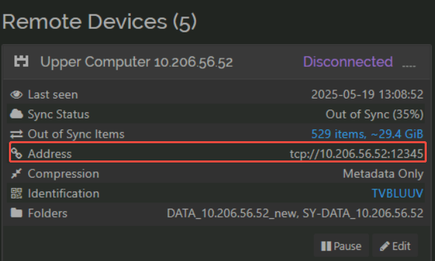

Is there any error (red small text) showing below the address now?
Here is an example of an error below an address:
The logs that you showed don’t say anything about why it’s disconnected, just that sync doesn’t work because it’s disconnected.

As you can see above, there is no error on address column.

Actually as you said, my scenario is similar with yours, the device would be already available again after a period. But I think it’s strange, I already added other devices, and they all have no this kind of scenario.
