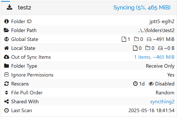

I’m testing under Windows now, with both “devices” running Syncthing v2.0.0-rc.14 (amd64), using the exact same file that caused problems on Android, and it also fails here. One difference between this and what happened on Android is that the Windows devices don’t disconnect, only the file transfer stops.
The file is stuck in transfer on the receiving side as below:
and the log complains about hash mismatch:
2025-05-16 18:42:30 request: jptt5-eglh2 uj~20250515-123351.zip 30670848 262144 hash mismatch
2025-05-16 18:42:30 request: jptt5-eglh2 uj~20250515-123351.zip 49283072 262144 hash mismatch
2025-05-16 18:42:31 receiveonly/jptt5-eglh2@0xc00062a008 closing uj~20250515-123351.zip
2025-05-16 18:42:31 progress emitter: bytes completed for jptt5-eglh2: 26993247
2025-05-16 18:42:31 sharedPullerState jptt5-eglh2 uj~20250515-123351.zip pullNeeded done -> 85
2025-05-16 18:42:31 sharedPullerState jptt5-eglh2 uj~20250515-123351.zip pullNeeded done -> 84
2025-05-16 18:42:31 receiveonly/jptt5-eglh2@0xc00062a008 new error for uj~20250515-123351.zip: finishing: pull: hash mismatch b8f7b9936bb378961d3f7c2e638d2c20331d38a81482e9a87792120150cc5c05 != 6b880559688b8c957791cdc739e9cf22c751ebab9195ed7d0aac0e1a2bd16a21
This happens with “Metadata Only” compression on both sides. I can provide debug logs, etc. if necessary.
