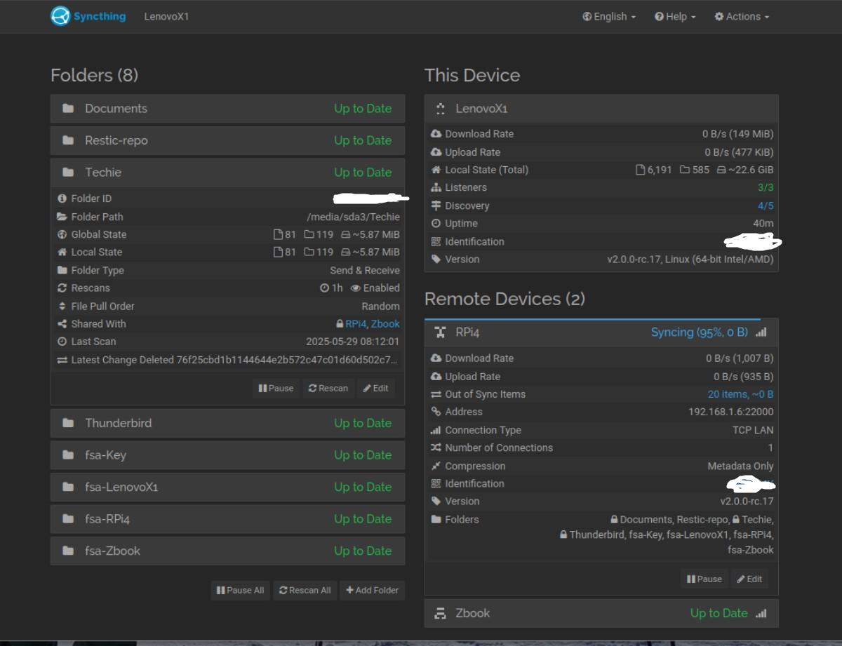

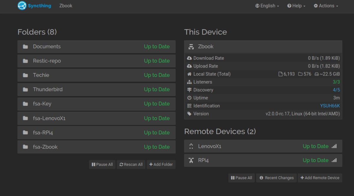

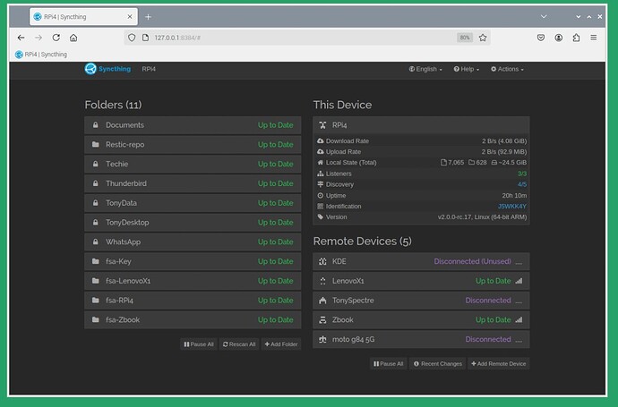

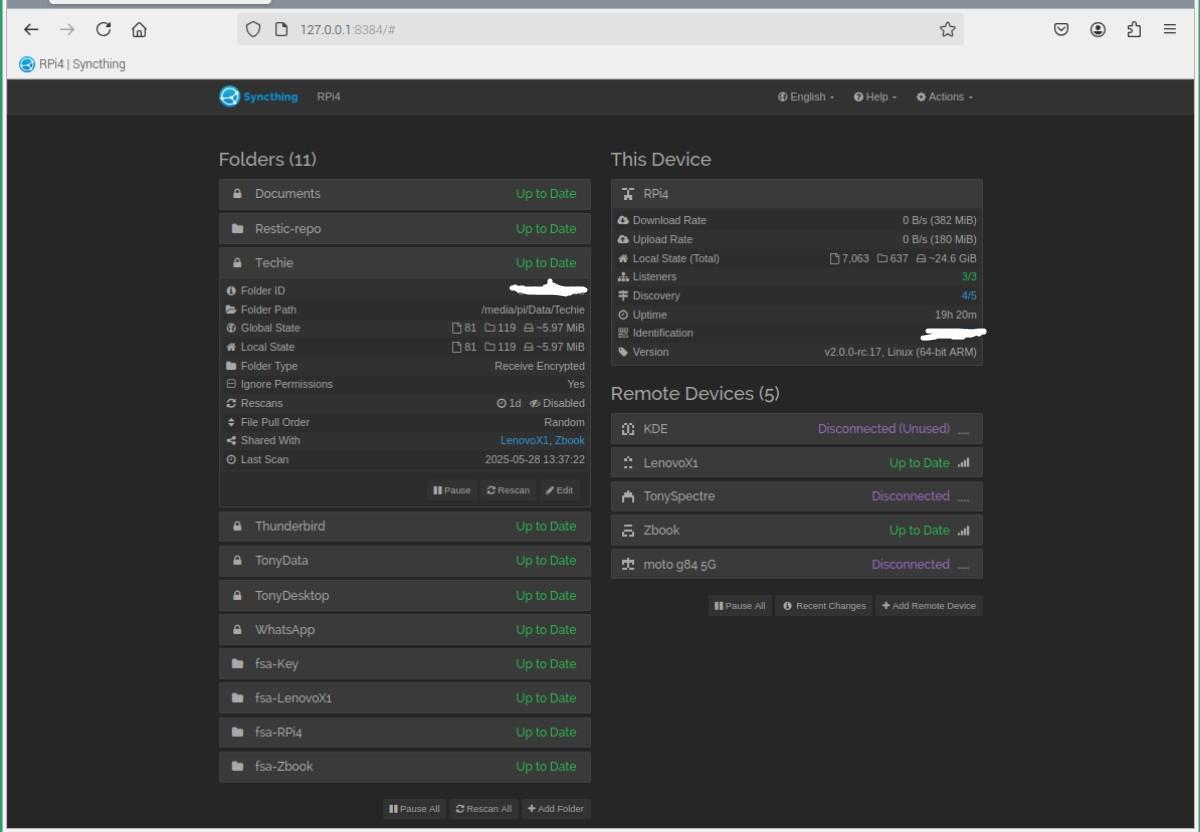

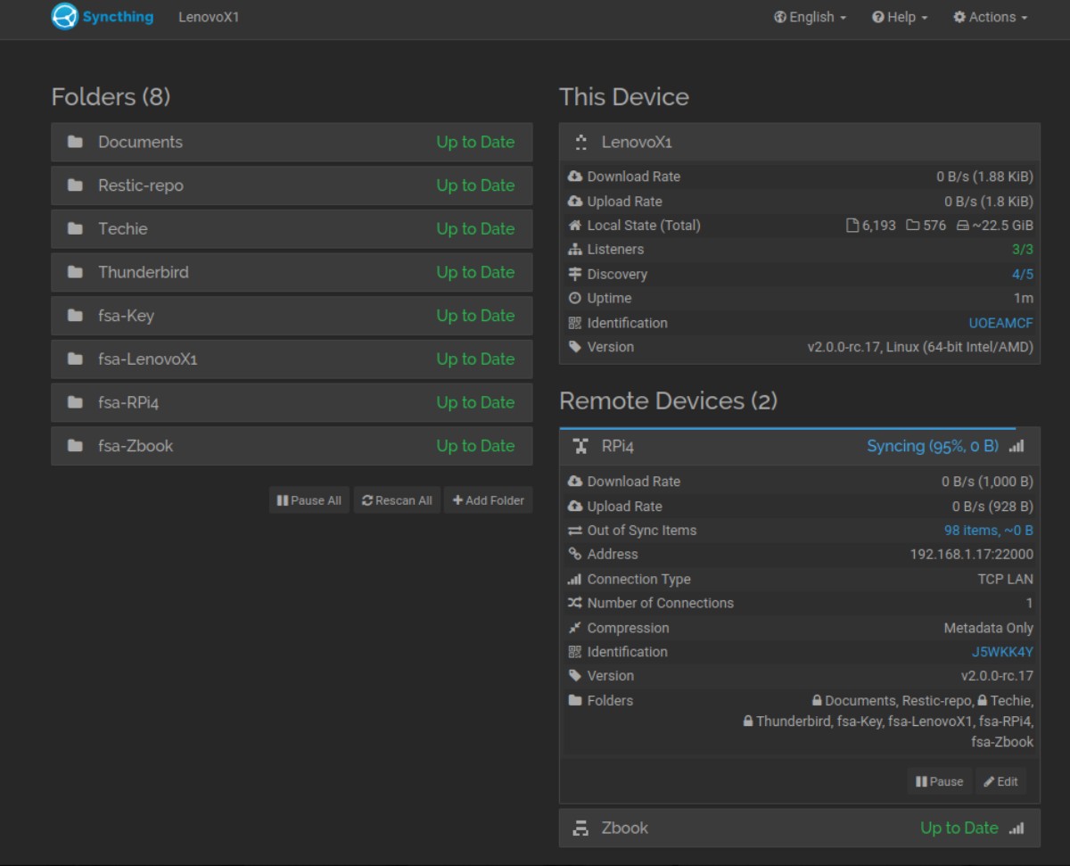

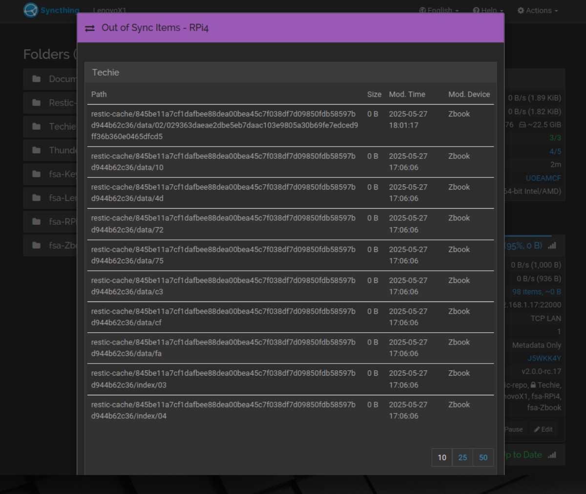

Screenshot of Laptop A and RPi4 showing all files synced. And Laptop B show 98 items out-of-sync along expanded modal showing items out-of-sync. All are 0 byte deleted restic cache files.
The three devices are connected in mesh mode with only the RPi4 being receive encrypted.
I’m happy to provide more info if needed.
Expand the folder on both sides for the counts? (LenovoX1 & RPi4)
I have replaced the affected receive-encrypted folder on the RPi4 and the issue reappeared. The three devices are showing the same file and folder count but this time 20 items are showing out-of-sync 95% 0b on the LenovoX1. Both the RPi4 and LenovoX1 were showing as synced until I brought the Zbook (laptop A) back online and the issue appeared again immediately.

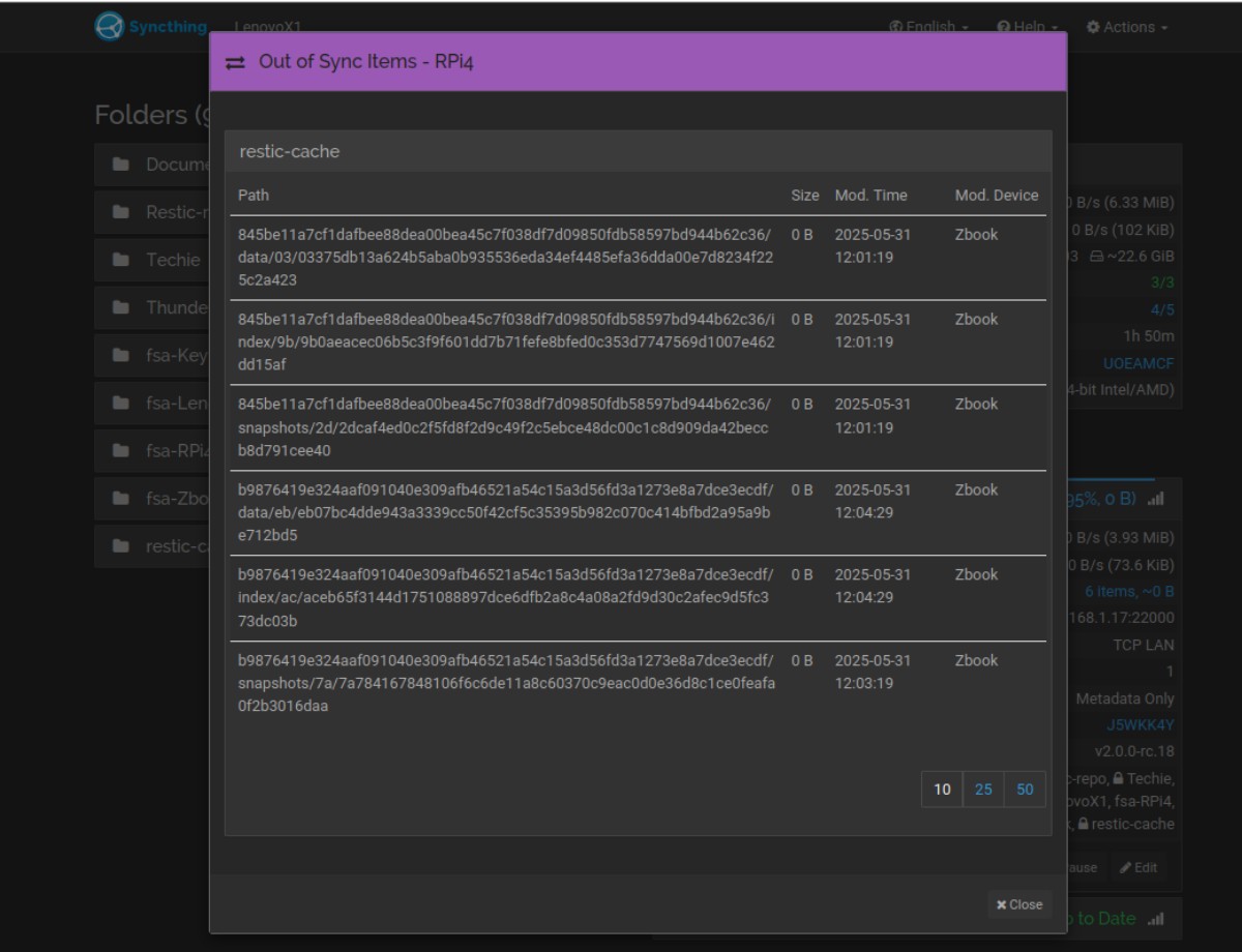

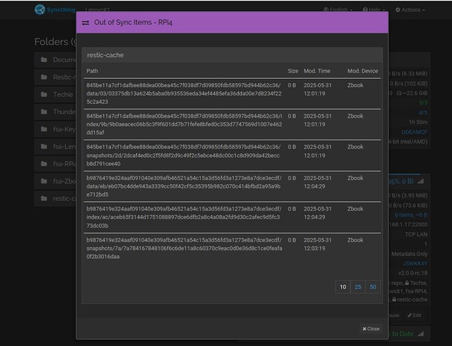

Ok, it has happened again (95% 0b out-of-sync on LenovoX1). All six files are from the same (now separate) folder, restic-cache. Files/folder count for local/global match, 65/222.
The database files for each device have been captured with syncthing debug database-statistics and are attached. sqildb-folder-restic-cache_RPi4.tar.gz (1.6 MB) sqldb-folder-restic-cache_Zbook.tar.gz (538.6 KB) sqldb-folder-restic-cache_LenovoX1.tar.gz (679.5 KB)
And out-of-sync items from LenovoX1 attached.

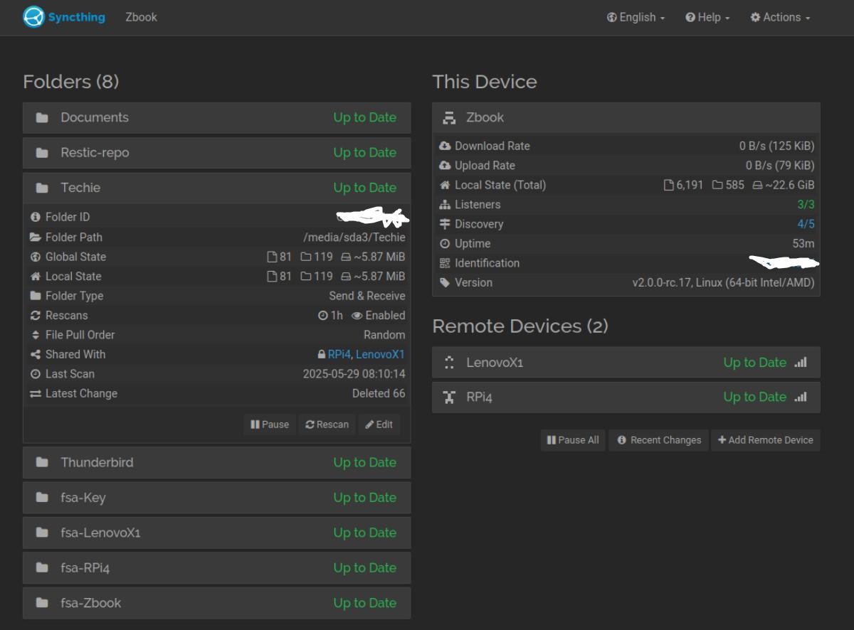

All those files are in there, in sync and not deleted. Not sure what to make of it. It’s like the database is from a situation prior to the one in the screenshot.
Would it be easier to track down with a hub and spoke arrangement?
Zbook ↔ RPi4 ↔ LenovoX1
BTW, the cached files/folders change with each two-hourly restic backup cycle, and that is reflected on each device but the out-of-sync number remains the same.
Is there a way to purge the database (–reset-deltas, --reset-database)?
It’s not a matter of that, it’s that the database contents don’t support what’s shown in the GUI. You sure they were taken at the same time? :slight_smile:
