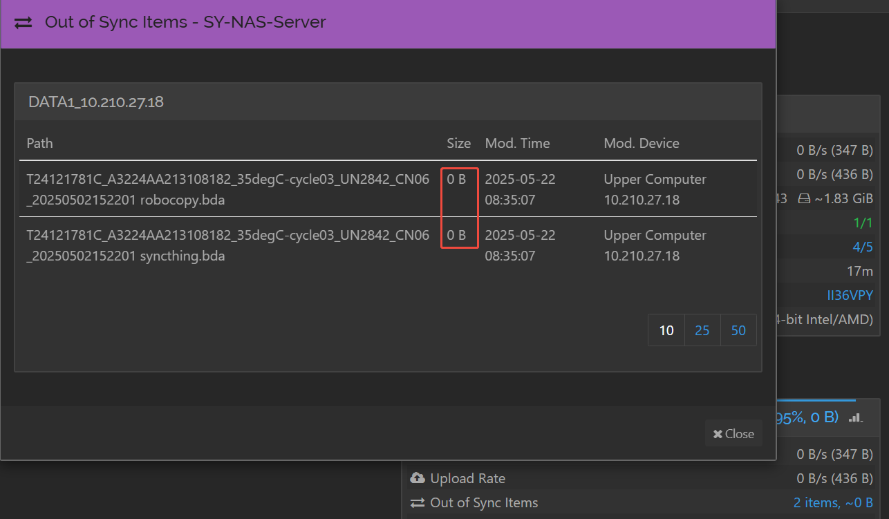

I set start command as below, and start Syncthing:
syncthing.exe --home=home --no-upgrade --audit --db-delete-retention-interval=0h1m
a few minutes later, the deleted items have not been deleted from DB, still show as below:
Indeed, because a 1 minute retention interval is nonsensical. The minimum allowed is 24 hours. The cleanup happens as part of the periodic maintenance which runs by default every 8 hours.
