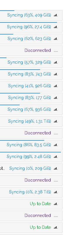

Only thing that jumps out is this
Lots of out of sync items, but the folder for the device says it’s up to date. Could it be due to the checkpoint returning 1 / large wal?

All folders are syncing, so a lot of things going on.
Edit: in your latest support bundle, what is going is that several folders are running the last phase of scanning, which is a database walk to look for deleted files. That takes a while…
This whole “can’t iterate over database things while doing something else” is a somewhat annoying limitation. I suspect we’ll end up with some best effort solution, but when there are a lot of folders doing different things at the same time we might need to accept that the wal file grows.
The alternative is to effectively buffer everything in ram which is usually worse (ram being smaller than disk).
You can also prevent this by setting a lower folder concurrency.
Conflicts or filesystem shenanigans is my guess, run with STTRACE=model
Or something between 1.29.4 and HEAD.
Random thought - I still haven’t properly looked into sqlite/2.0, so this might be entirely irrelevant in the new setup and generally take it with a bag of salt: I remember someone early on mentioning that it’s a typical trap to only use a single database (file) for an entire application with sqlite. Maybe it would be worth considering having separate DBs per folder.
The obvious tradeoff is losing transactionality for anything involving more than one folder. However I don’t think there is much there, if anything. From memory/quick look at old db code it’s only the block list and the block map. Resp. looking at the block map, it seems to be per folder as well, we just use it for a bunch (all?) folders during pulling. It should be ok not to have transactionality here, neither a false block miss (not great, but only performance) nor a false block positive (we verify it) seems problematic.
Block list as it was before would be fine, as we don’t delete entries there under normal operations, only on regular garbage collection. However with my lack of knowledge of the new setup, I can’t say if it’s reasonably doable there (separate DB for block lists, append-only except regular cleanups) - seems concievable, but things always seem concievable if you aren’t in the weeds.
