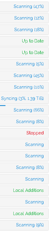

Just an FYI, for beta 4, I blew away the index files to replicate the large wal file that appeared under beta3. it’s still growing…
and im not yet finished scanning the folders…
I also know I have a lot of folders and handle very large files so maybe the large wal is to be expected. I am most definitely not a typical Syncthing user!!!

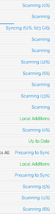

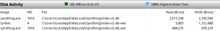

I think there’s something else going on. It’s getting bloaty…
but, yesterday, after I restarted beta3, not all the folders had scanned fully yet the wal size was smaller and index2 was around 16Gb in the morning. It’s as if the initial scan on an empty database is looping and filling out? (wild speculation), but a database that’s already in use seems to handle the indexing a whole lot better.
Update. I have left it running over night, but I think it’s stalling internally. It claims it’s been running for 8h 26m, but it’s around 12 hours. The indexing is still running, but the log updates are very slow now

at memory usage is high
I asked it to create a support package, but nothing is happening. However there is disk activity
Index files are

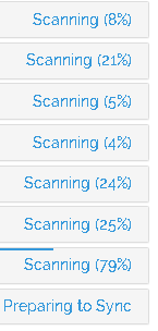

So i’m going to do a restart but will pause everything and start with a blank db in case it’s the volume of folders that’s the cause
At least checkpointing and WAL size are looking good now.
