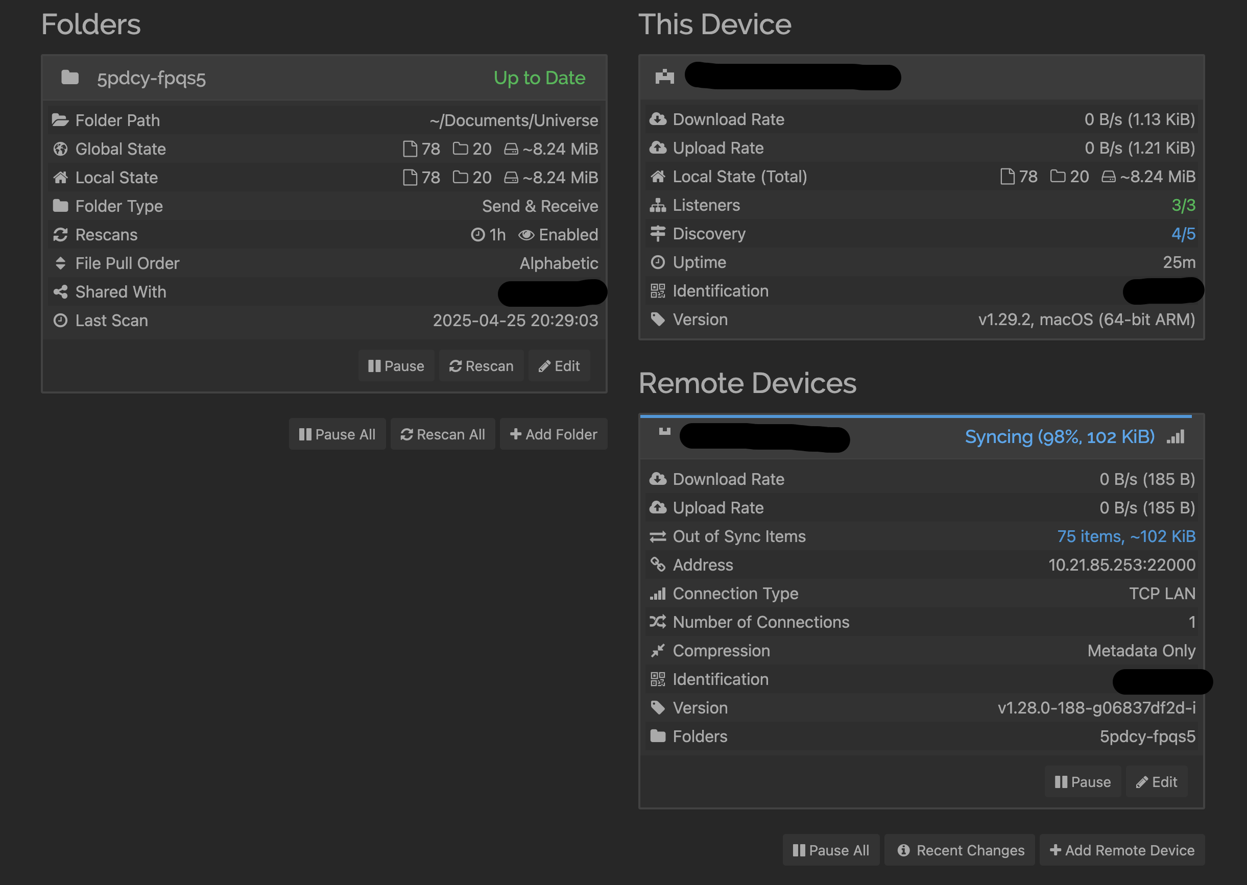

Hello! Hoping to have some assistance or direction on what to do.

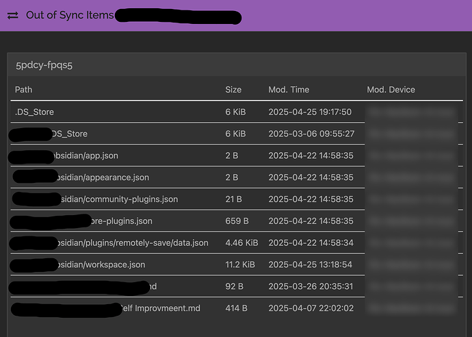

Trying to help a friend sync their Obsidian files across devices (Mac → iPhone and potentially iPad). Got the app and linked devices but it keeps stopping at 98% and not uploading or downloading anything else.
Here are two screenshots, in case they help.
I have noted a similarity to this post however since I’m using a mac I couldn’t figure out how to make it work.
Super appreciate any response that could point me towards resolving this issue, thanks!
The reset-deltas command-line argument works the same on the Mac. Use Terminal to stop Syncthing and start it again with that option.

You want to start Syncthing with the reset-deltas command-line switch.
So if you use pkill to stop Syncthing, then start it again with that command-line switch.
On my Mac, I have Syncthing starting automatically per Starting Syncthing Automatically — Syncthing v0.11 documentation using the “without Homebrew” method. So this is what I would do in your shoes:
pkill Syncthing
~/bin/syncthing --reset-deltas
Let us know if this fixes things for you!
