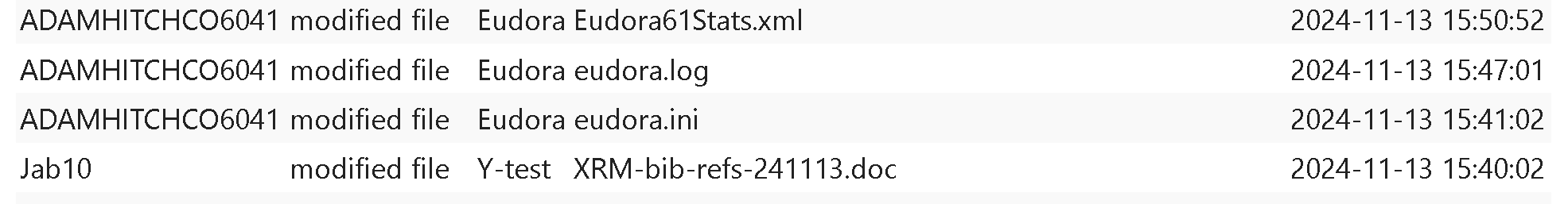

However it is still not sync-ing. Is there a way to execute ‘sync now’ ?? I hit the rescan button at the button of the panel but it did seem to pick up there a file to transfer I dropped the 'rescan time from 1 hour to 1 min - again no transfer.
The changes section does show a change to Jab10 (not Jab9)
something is still wrong.
