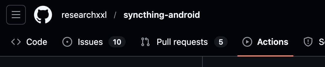

Go to Actions

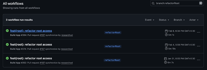

Filter workflows with branch:refactorRoot. And open the latest(first) run.

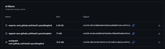

Scroll down to Artifacts and download the signed apk (second in the image below)

I must be logged in to be able to download.
The build does not replace the original build but creates a second installation.

It appears you can no longer find this on the Actions tab. Is there another way to find the version that works with root?
That’s because old runs are cleaned up. I have triggered a new run. You can find the latest one now.
