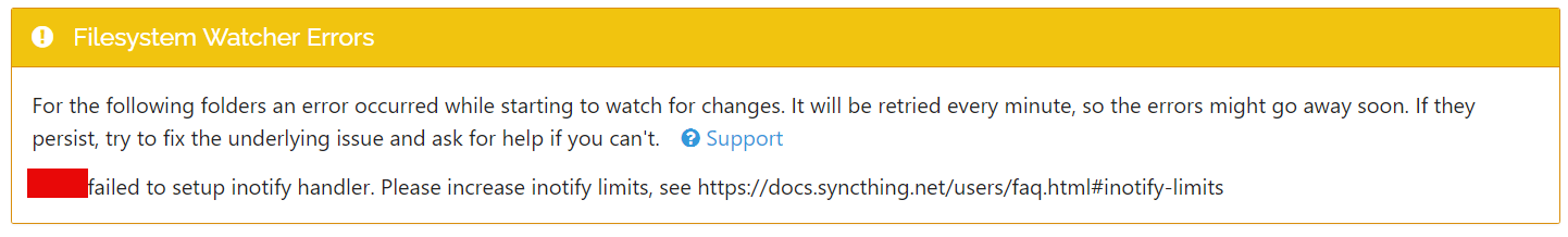

That installation also has a seemingly unrelated issue.
The issue shown only happens for directional folders (e.g. send only).

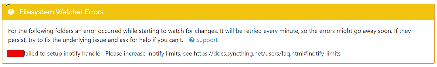

Same folder as above.

One question: What user is being used for the native syncthing install on Synology?
It’s been years since I worked with a Synology NAS so the default setting could have changed, but it looks like it’s still really low. Open a terminal on the Synology and check the Linux kernel setting for /proc/sys/fs/inotify/max_user_watches.
Whatever the number is, it must be large enough to handle the total number of files and directories being watched. Not only by Syncthing, but by all other processes running under the same user ID.
Thank you!
I have been able to resolve the inotify issue on both systems!
On the syno, I ended creating a boot task and, on the truenas, I maintained a configuration variable. Both solutions can be found in other posts on this forum with more details.
I have been able to resolve the permission problems and so all folders are synced now. Solution for permission problem is here.
