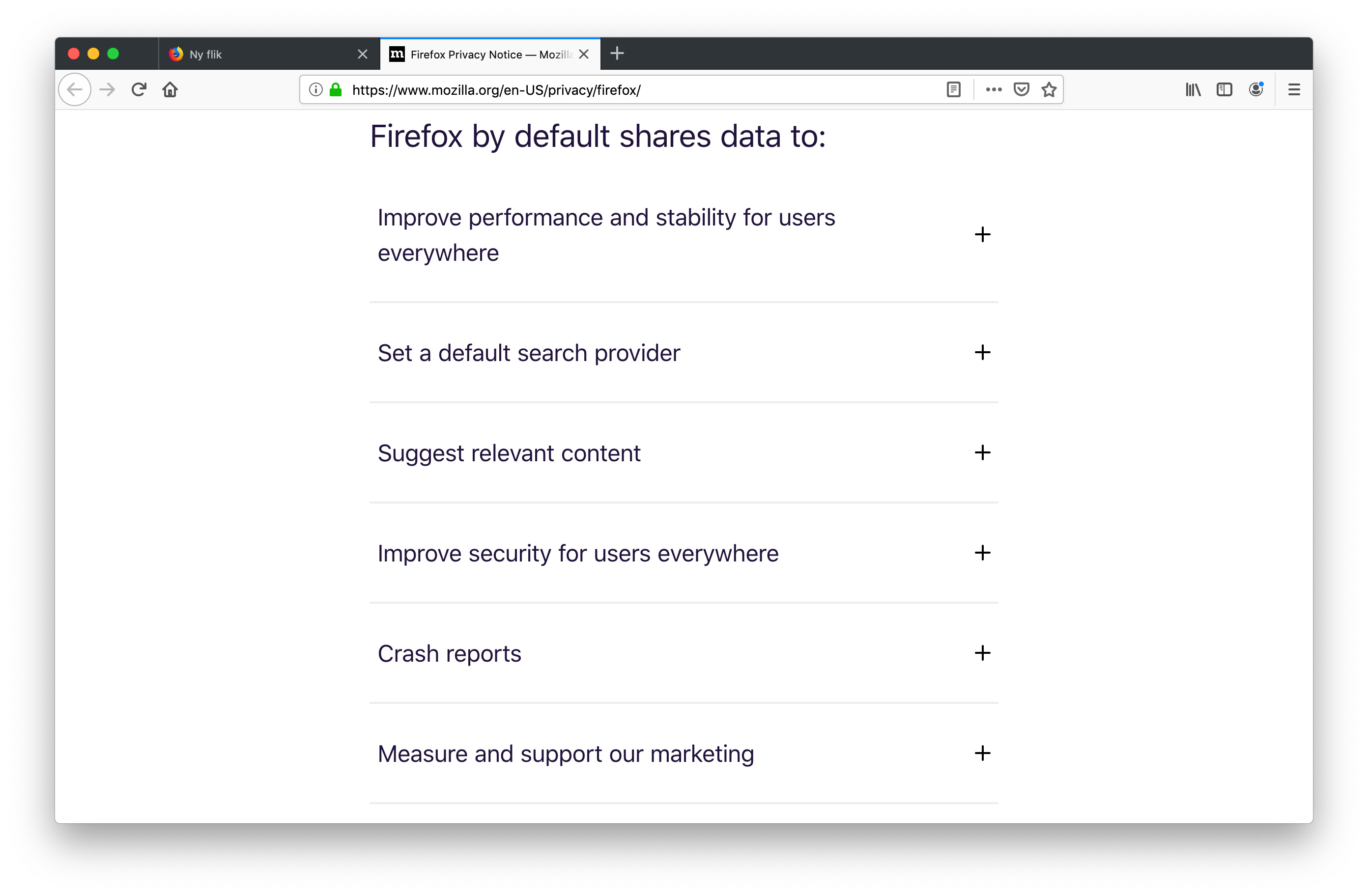

Firefox sends everything by default and opens a tab on first start (in the background, so you have to notice it yourself) explaining their privacy focus;
