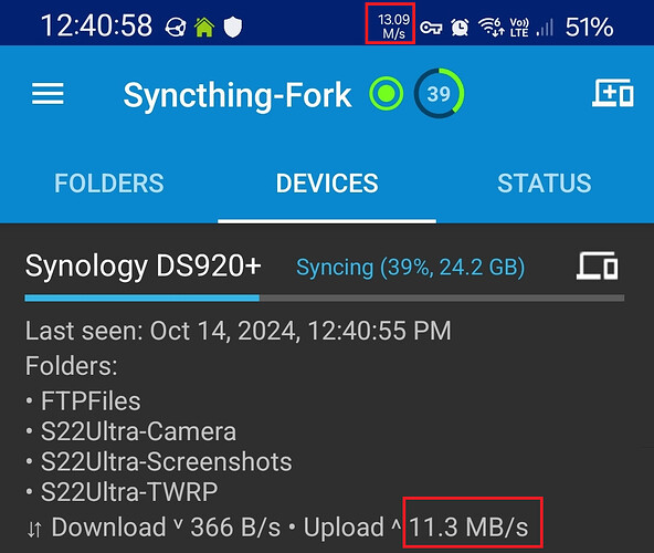

I’m syncing files from my Android 14 phone to my Synology NAS. As these are large files (partitions backups made in TWRP) I discovered that speed sync is around 7-times slower than my local WiFi. So I have 1 Gig/s LAN network with WiFi 6a 5GHz and iPerf shows me that between my phone and NAS there is a throughput around 725 Mbit/s:
but Syncthing-Fork is sending files at speed around 100 Mbit/s (11-13 MB/s) so it is 7 times slower then what iPerf measured:
