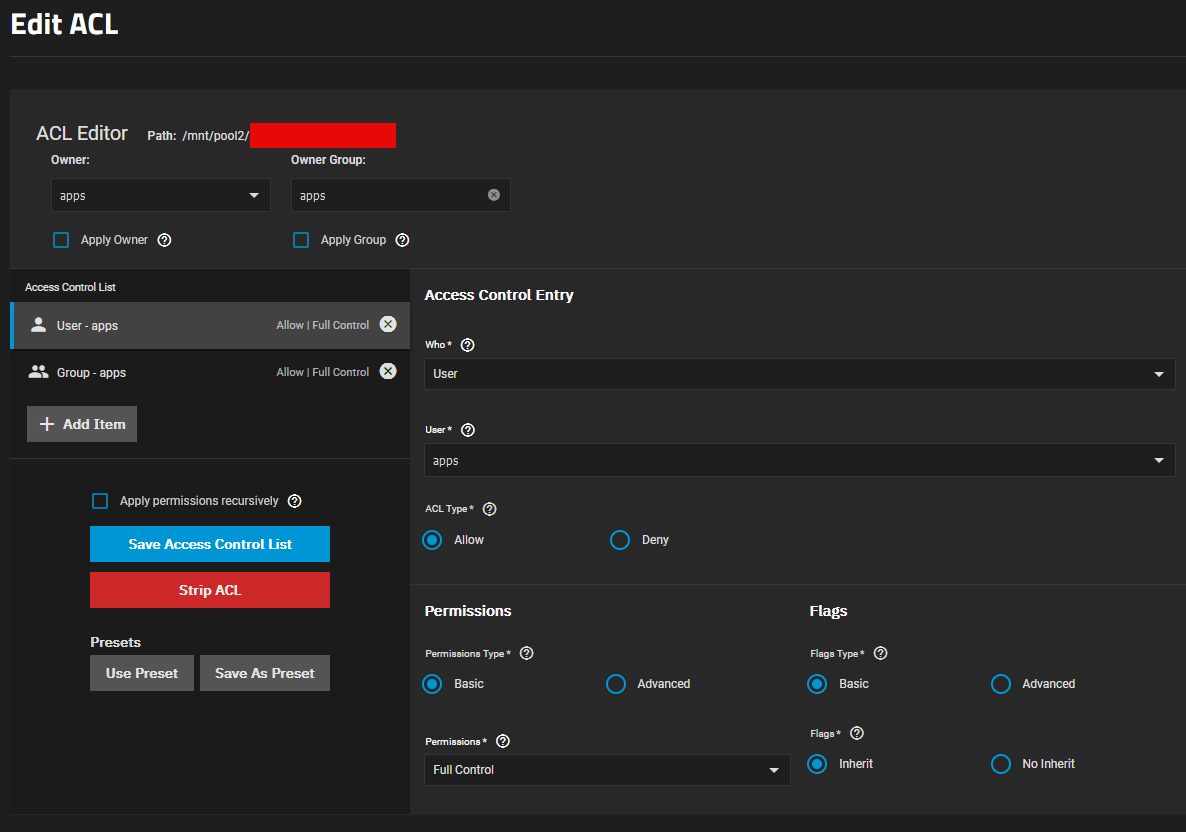

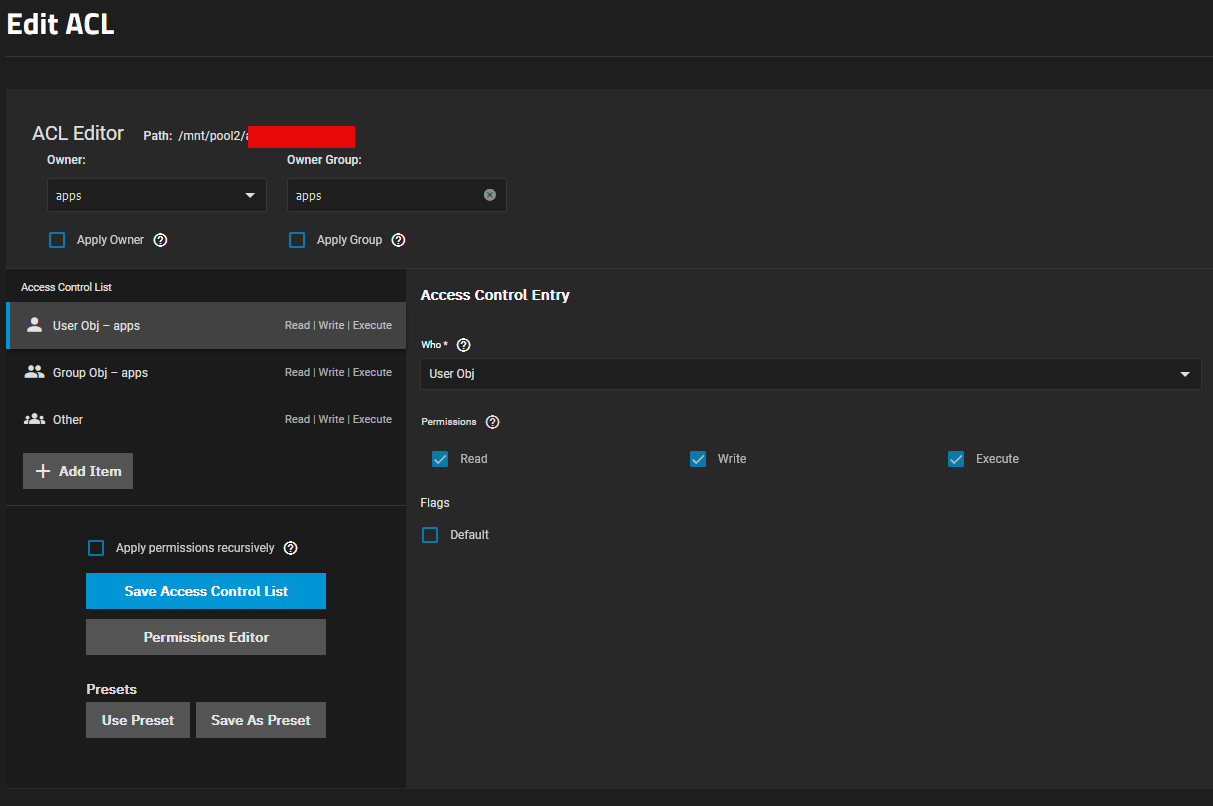

The ACL from the folder that is giving the issue.
I don’t see a connection to permissions here. The message tells you what is wrong: The folder contains some files locally (on the receive-only side), but the sender side informed about the deletion of the whole folder. The problem is, it didn’t send a deletion for the remaining files within, which are still in the receiver’s folder. Thus they don’t get deleted and therefore the parent directory cannot either.

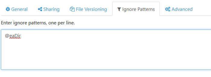

Sorry, I forgot to add the following screenshot to show my Ignore patterns used for all folders.

Try this: (?d)@eaDir

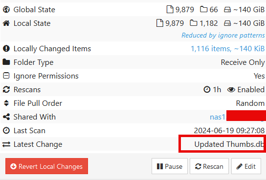

Bad news is that I ended up with the Local Additions issue again. Once again it shows roughly 1100 folders that are not in sync with the source.
I am using the file browser application to validate the folders and files. Is it possible that the app is not showing me what has been added locally?
I did notice two issues this time.
2024-06-19_09-31-48
The Receive Only target shows that it has received a Thumbs.db file, but I cannot find this file in the Send Only folder.

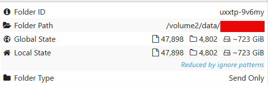

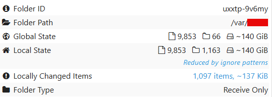

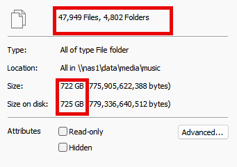

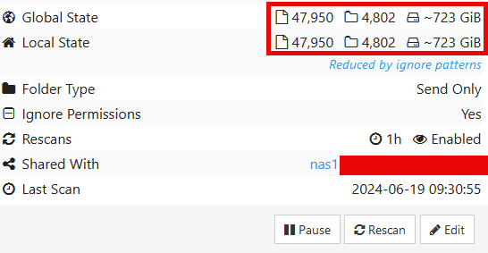

But there is an even bigger problem which also explains why the re-sync went so fast. The Send Only folder has more folders/files than the Receive Only folder even though it shows as Up to date and Local Additions on the other end. I mean like 580GB are missing. What’s going on here?
2024-06-19_10-02-45
The Send only folder as seen from Windows. Fairly close to the Send only folder on the Synology.

Are you sure the folder IDs match? That is not visible in the screenshots. Are the devices showing as connected? What are the ignore patterns? Have you checked the list of locally added items? How do they differ?
Note that manually deleting something within a receive-only folder also counts as a “local addition”. So your problem might go away if you just press the Revert Local Changes button.
Mismatching global state is usually a matter of different ignore patterns. And that includes stuff that was ignored on the sending side after having previously been announced to other peers. (Probably not the case here, as your sender has more data on global state.)

Here are the folder IDs.
2024-06-19_11-49-37
2024-06-19_11-49-06

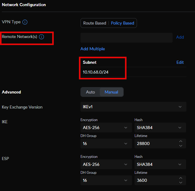

In my home, I have a Ubiquiti UDMPRO which is connected to a remote Sophos SG (legacy) via a Site-To-Site VPN (IPSec). The remote network is 10.10.x.y and my local network is 192.168.x.y. So, I just “mounted” it using built-in UDMPRO capabilities. That has been working for years and I have done some recent testing to confirm that there are no issues.
I am using the same Ignore patterns on all folders.

I don’t understand this part of your setup. Are you “mounting” it as some kind of mapped network drive? NFS or Samba / CIFS, WebDAV or something? How does that fit together with using Syncthing?
The ignore patterns definitely don’t need to include the .stfolder marker, nor the .stignore file. Both are not synced anyway. Marking them as (?d) would also be incorrect, because if they prevented a folder from being deleted, that would be the configured root folder, which Syncthing obviously wouldn’t try to delete. And finally, be aware that such a pattern matches the name in any subdirectory, recursively. You’d need to anchor it like /.stignore if you actually mean just that one top-level file.

Mounting the remote network locally is just a basic feature provided by Ubiquiti.
