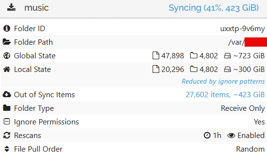

I went ahead with removing the folder and it is still scanning… Here is a quick snaphot showing the progress.
2024-06-19_14-03-27
The global state count looks correct, but shouldn’t the local state be 0 when I am still on the initial scan or is it already copying stuff while scanning?
Just a quick update. It is now syncing folders and files. The global count has remained the same which is good I think. The local count is a different story. At times I am suspicious that it hasn’t removed any local folders and files.

Some terminology and background:
  • “Mounting” usually refers to making a remote filesystem available as part of your local system’s file name space. E.g. mapping a CIFS share as a drive letter in Windows.
  • The “global state” takes into consideration all currently announced items in a folder as collected from all involved devices. For a receive-only folder, that’s basically the index data which the remote devices sent. For other types, it includes the local state as well. It is normal that these numbers rise gradually after adding a folder, as index data is coming in from remote.
  • The “local state” is updated by scanning what the local folder currently contains. This also takes a while, thus numbers can rise slowly at the beginning until the first scan is finished.
  • “Local additions” in a receive-only folder can actually be deletions as well. If you see a folder listed there that is not on the receiver’s disk, it means that it was once there but then deleted. Basically it says: “This device has received the state from the other devices, and on top of that / additionally, a change was made. The change is deletion of a folder.” That’s why it’s called “local additions” even for deleted items.
If the global state doesn’t match between devices (after it has settled), that’s a bug in the index data exchange. We’ve seen such situations sometimes and it’s still not clear where the cause lies. But the remedy is clear - removing the folder (from Syncthing) on one or both sides, adding it again with the same settings. Another way to do that is the --reset-database command line switch, but it affects all of Syncthing’s folders.
Other possible reasons are mismatching ignore patterns (ruled out in your case) and not yet completed index data exchange (needs only patience). If you don’t see the global state rising anymore, and it’s stuck below the numbers which the other device tells you, then you’ve hit the known, but hard to reproduce bug. On the forum you can find several topics about that.
Syncthing will not delete any local items (even in a receive-only folder) during first synchronization. Which this is in your case, after adding the folder again from scratch. When it finishes syncing, any additional local items will show up as local additions.
