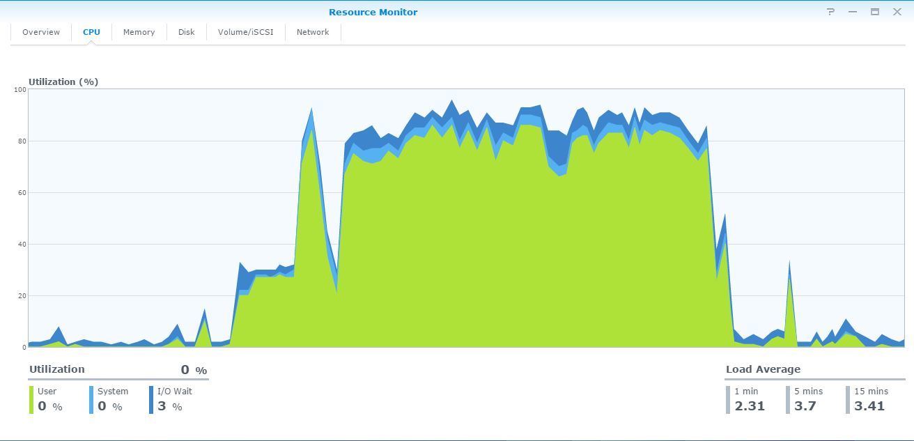

just a screenshot from initial index exchange. Right now scanning of VM file change is about to finish and then it will start syncing. Well, just to say, startup looks good to me, system is reasonably utilized…

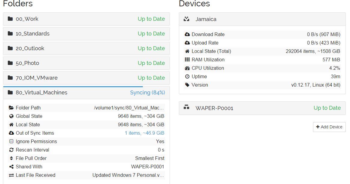

And now it’s syncing…

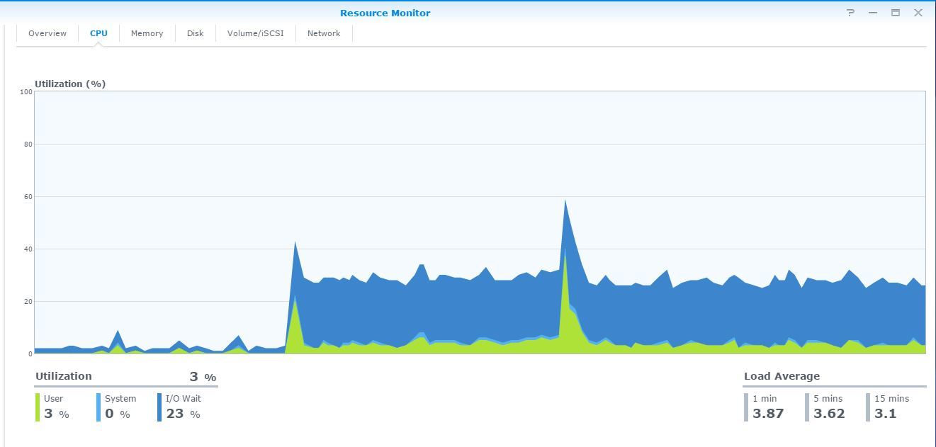

Nothing is being downloaded, just reusing existing blocks…and system usage is like this. Log attached as well. I will keep logging overnight as well, until the whole file is synced and can post full log then. sync.txt (5.6 MB)

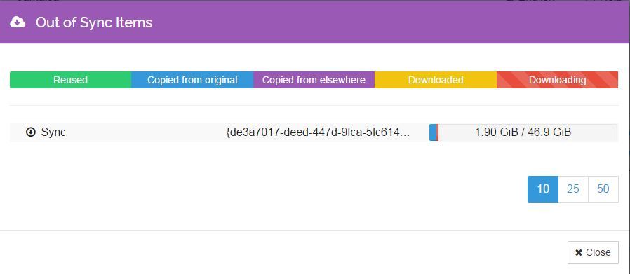

and also screenshot from GUI showing blocks are just being reused:

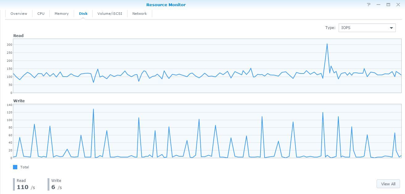

And maybe one more thing…I’m not too sure how to monitor HDD usage, this is one more screenshot. I’m not sure if ~120 IOPS is maximum what standard SATA disks can do, and in fact system can be already maxed out even if IO wait shows only 25%?!?
