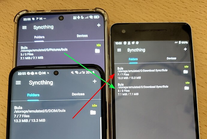

I would like to use an old Pixel phone to back-up photos from 2-3 other devices. I have several identically names albums on all devices that should all be backed-up to the same corresponding folder. Let’s say that Screenshots from device 1 and Screenshots from device 2 have to both be copied to Screenshots folder on the Pixel.
I have tested and it works but I had to create two different receiving folders on the Pixel that share the same location. And I feel I might be missing something and there could be an easier way how to achieve this.
Any ideas? references? I was only able to find this but the topic is dead.
The sources folders on the left are both set as ‘send only’ while the pixel on the right to ‘receive only’.
At its core, Syncthing is a bidirectional sync tool – keeping a pair of linked folders near-mirror images of one another.
But what you’re trying to do is “merge” folders from Pixel A and Pixel B onto a single folder on Pixel C, which isn’t a scenario that Syncthing supports.
Because the source folders on Pixel A an B are set to “Send Only”, they will forever be out-of-sync with Pixel C as long as Pixel A and B don’t hold the same files (i.e. if Pixel A has file named “pixel_a.jpg” that doesn’t exist on Pixel B).
To avoid issues, it’s best to use unique destination folders, e.g. /storage/emulated/0/Download Sync/Pixel A and /storage/emulated/0/Download Sync/Pixel B.
