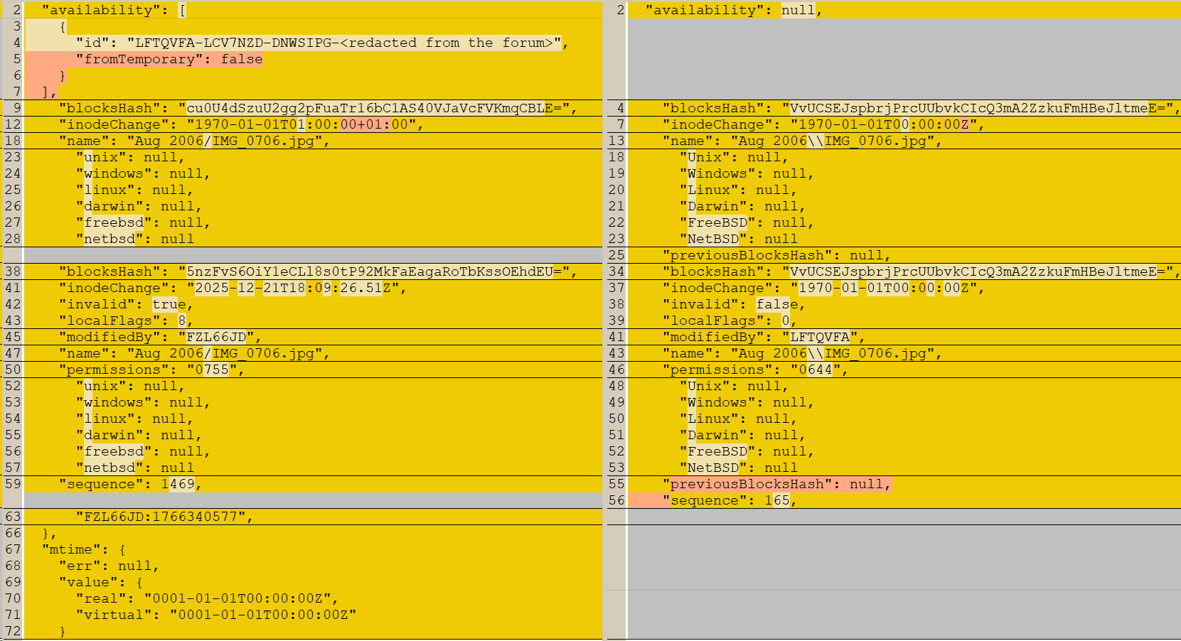

Just for the record, this is what you get if you compare the differences between the two:
Anyone have any idea what it all means? The only significant difference I see is that the receiving end has 2 different hashes for the file and neither match the hash that the sender used.
