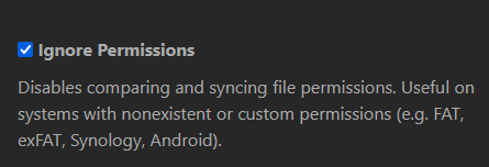

And as I have already said above ( Files are locally modified when logs says they are unchanged - #3 by Kylotan ) , I set “Ignore Permissions” to Yes long ago and it makes no difference, despite rescans.
I posted API results from both sides for a sample file affected by this and they both seem to be returning “noPermissions: false” which, if it relates to the same setting, implies it might be ignoring what I select in the UI.
Is the “Ignore Permissions” option enabled in the Advanced tab when you edit the affected folder? I’m asking because there are also settings for “Default Folder” if you go to Actions → Settings, but those are only applied when you create new folders, and not to already existing folders.

Yes.
The send side looks like this:
And the receive side looks identical, except in light mode…
