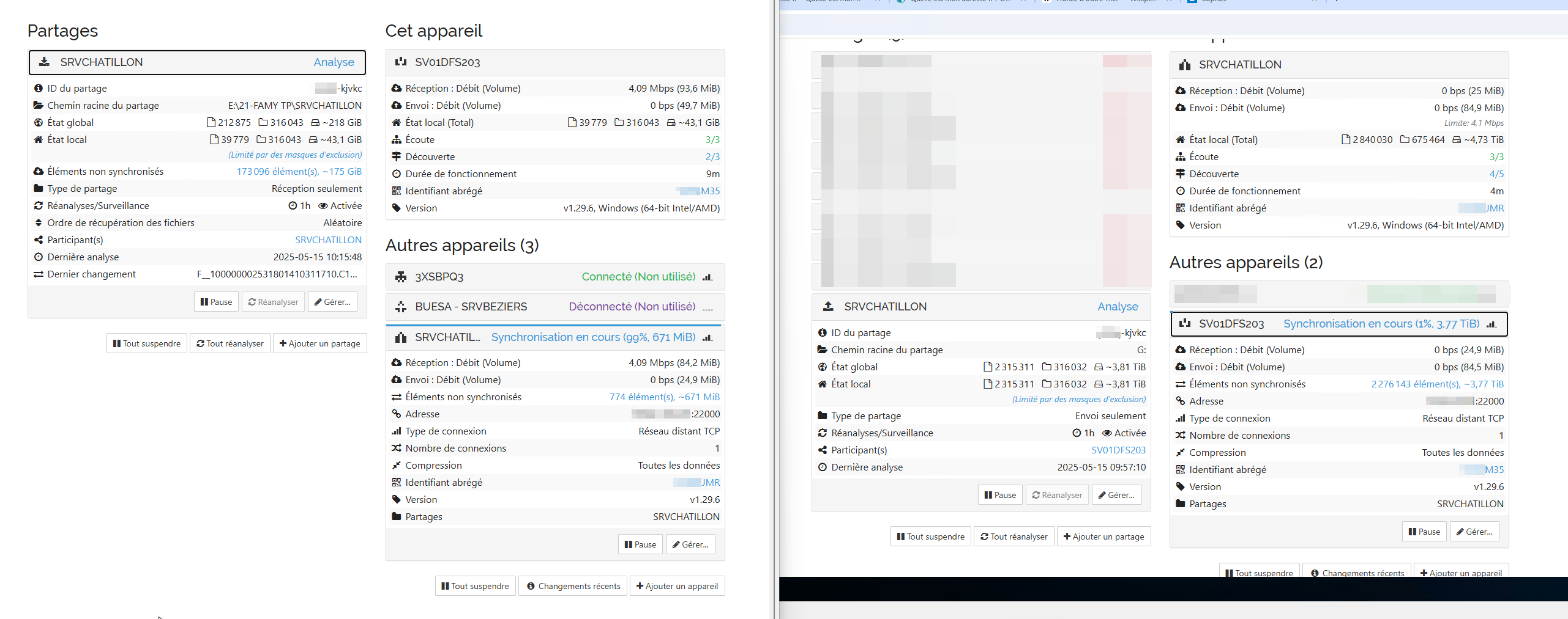

Hello, i have a problem.
I want use syncthing to migrate datas entreprise “A”(source) to entreprise “B”(destination) through WAN.
I have open tcp/udp:22000 outbound and redirect tcp/udp:22000 inbound for Ent. A and Ent. B.
Ent.A is send only and Ent B is receive only.

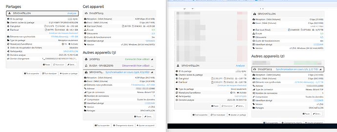

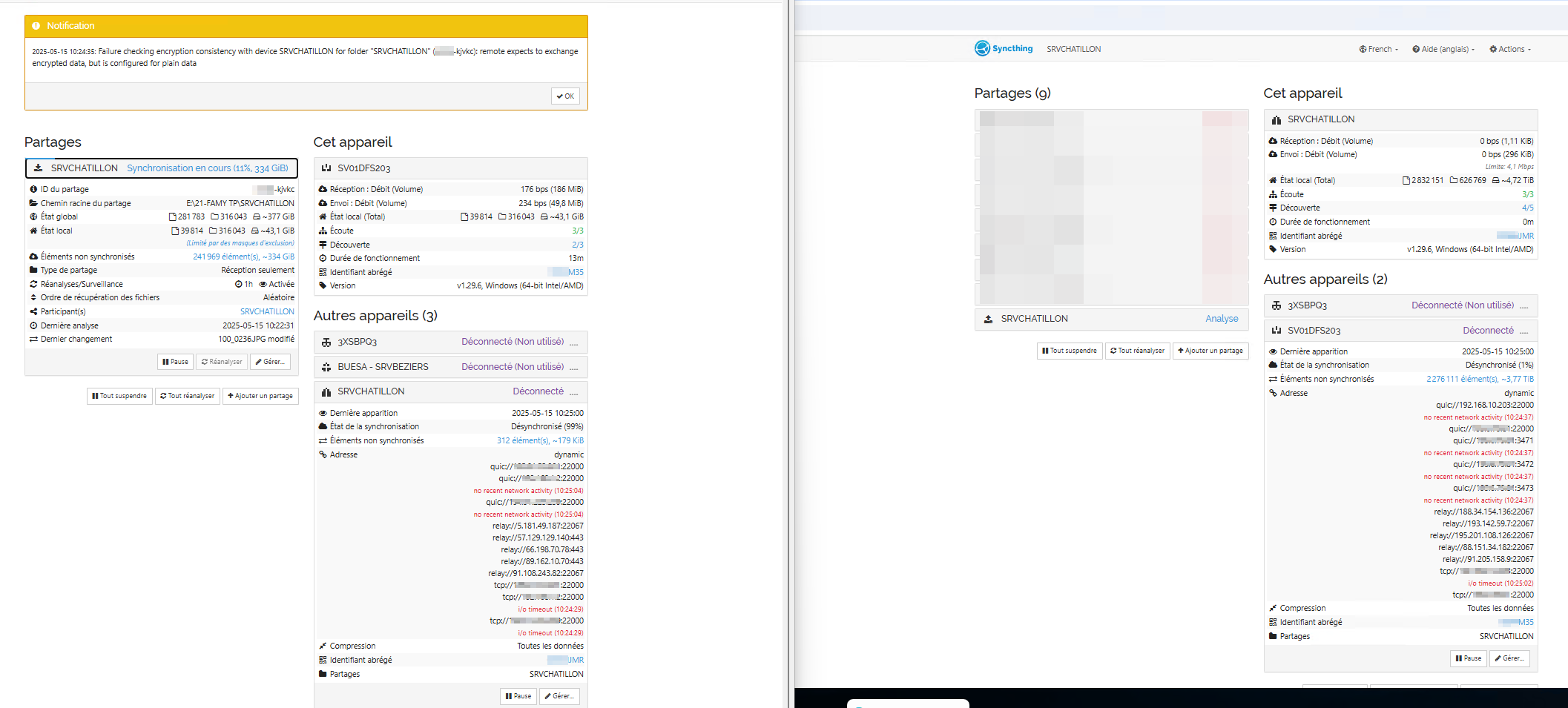

The initial configuration works and after reboot syncthing i have this message on syncthing entreprise B :
“Failure checking encryption consistency with device ENTREPRISE A for folder “Sync” (xxxx-xxxxx): remote expects to exchange encrypted data, but is configured for plain data”
Device Entreprise A and entreprise B is deconnect.
Why ?

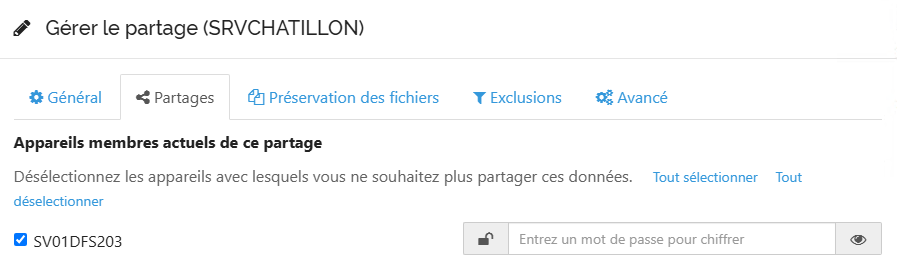

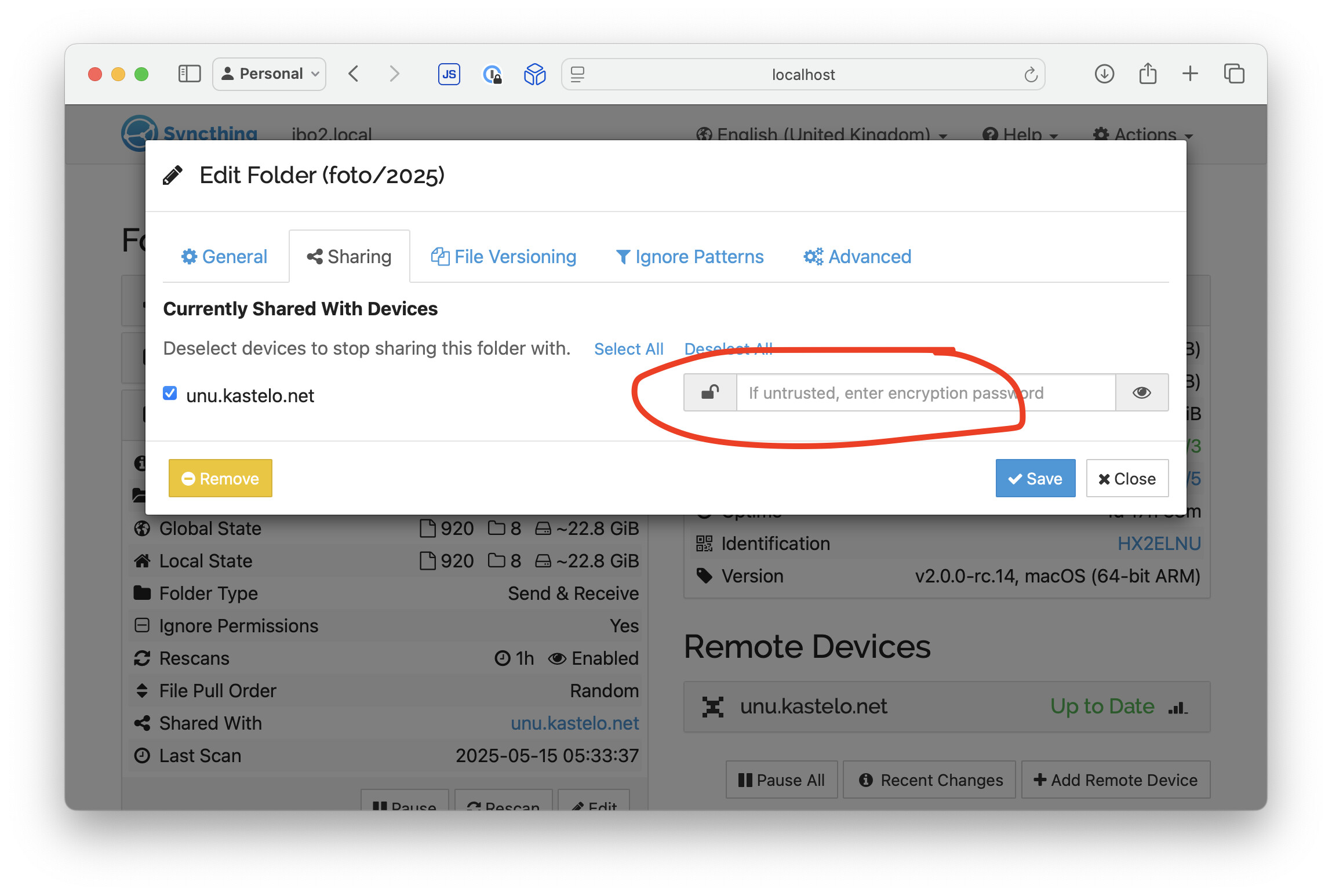

You set an encryption password but the other side is set to receive unencrypted data.
Hello, I have not configure encryption password
Initial configuration works and after reboot service :
I don’t understand this problem.

Check the sharing settings in both directions.
Fascinating. And also they are connected and syncing in one of your screenshots. No real idea what’s going on, perhaps a support bundle from both sides would clarify.

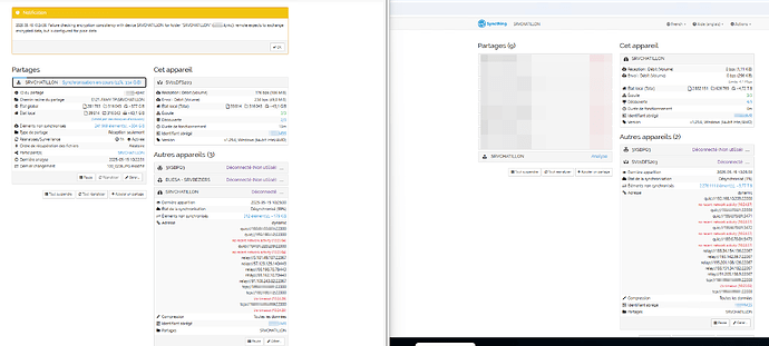

I reset syncthing, reproduct this problem and generate a support bundle for my 2 devices.

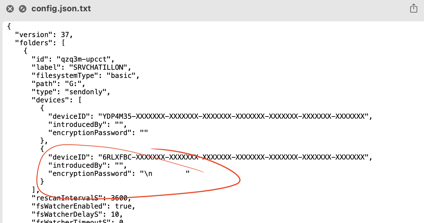

There’s an encryption password set on 6RLXFBC, consisting of a newline and some spaces – maybe from manual config hackery…? Better remove that. It’s actually for itself which doesn’t make much sense and shouldn’t even matter, but I guess the consistency check is a little bit overeager.
Very very Thanks !!! it’s works !
Effectivelly i have a script in task manager for change inbound / outbound maxSendKbps workhours / offhours.
The script generate "\n "

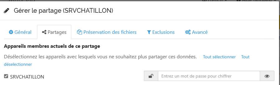

Before exec :
After exec :
I remove on config.xml and it’s ok.
