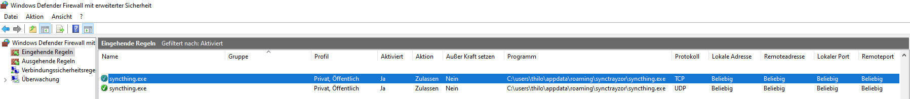

Yeah, could be. Just now, when I started my Linux Mint Syncthing I was not able to discover GTMM2P. But as soon as I restarted Synctrayzor on GTMM2P, it connected. It looks like the discovery has to be an outgoing call from Windows. I really tried to allow Syncthing/Synctrayzor in Windows Firewall, but alas…
I will try to assign different listening ports. Thank you!
Is your network in Windows set to private? It needs to be in order to allow direct connections.
It is public, but Syncthing is set to private.
If you’re speaking about the screenshot above, it only means that Syncthing is allowed to connect on a private network. If the network itself is set to public though, the setting has no effect. I’m not sure if allowing just Syncthing to connect on public networks will be enough for the OS to allow direct connections inside the application.
From my experience, unless you’ve got a good reason not to do so, switching the network to private usually fixes most of connectivity issues with Windows devices.
Sorry for the German. Can’t change my OS language that easily, but this seems pretty clear to me that incoming packets are allowed.
But will do some more tests one of these days. Also with firewall set to private.
Just for the record, when speaking about setting the network to “private”, I’m thinking about https://support.microsoft.com/windows/make-a-wi-fi-network-public-or-private-in-windows-0460117d-8d3e-a7ac-f003-7a0da607448d, not the firewall.
