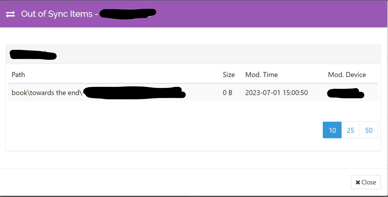

1 Device on backup device says sync with 1 item out of sync
Hi
My main computer is a backup device for my family phones and computers and my Wife has a laptop and a work computer where she when she has time work on her book.
So on my backup I ignore Delete on the Book folder and then it is synced to both Work computer and Laptop.
What is interesting is that the Work computer on my backup PC says Syncing 95%, 0B.
I tried removing the 2 files from the Work computer but for some reason did syncthing not sync but when I moved them back did 1 of the 2 files stop saying it was out of sync but the second is still showing as not in sync when the file on the laptop, my backup and her work pc are 100% identically.
I then tried removing them from my backup device aka moving them away, waited till the Work pc deleted them, and added them back and yet even after this and the work pc is now fully synced does backup device still show as 1 item out of sync as screenshot above shows.
Now off course the Laptop which is atm not on shows 2 items out of sync instead of up to date but I hope it will just see files are there or update and be fine-
Any idea how to fix it and why it is only the actual backup device that claim her work machine was not in sync when it was?

Filename: “13 A change in the weather.docx”
for some reason the box above shows it as: “~$ A change in the weather.docx” no idea why.
Anyway thats the name of the file the other file it complained about was: “~WRL0003.tmp”
And I just noticed on the book folder there is a file called: “~$ A change in the weather.docx” and is 1kb I will just go and check if it is on the work pc 2 when I get a chance and get back to you.
And I will also when she get home get her to open her laptop to check it for same file.
Because the file with the full name is there and correct in date, time, size and content on all 3 devices this is getting very curious, I actually thought the weird stuff was Syncthing truncating so I never double checked the folder until now when I was getting the full name for you.
The ~$ thing is a temporary file created by MS Office while editing its files, so that you can’t open and edit them on different machines at the same time. These temporary files are hidden by default in Windows.
True and syncthing off course see them and try syncing them is there a way to ignore the words temp files to avoid this issue?
I completely forgot about Office temp file system.
In addition to ~$ A change in the weather.docx, ~WRL0003.tmp is also a temporary work file created by MS Word.

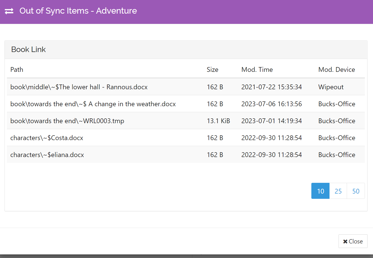

Hi so new development.
The laptop was on the other day and on it until I added that .stignore list claimed like “bakcup” pc the temp files was missing but what is strange is that my “backup” now has the problems of showing several temp files from her work PC not syncing with her laptop.
Any idea how to get rid of them?
As I even have times where “backup” pc shows yellow triangles complaining about this.
I have tried to copy over the files to laptop and to my pc and remove the ignore files in hope of it going 100% then adding them back and remove the temp files.
As I have removed them from the backup machine as they shouldn’t be there for obvious reasons. The work PC is fine on both ends as far I know.
So laptop and work pc shows up to date, and on backup does the work pc show up to date so does the actual folder. I have not yet tried adding the .stignore file to the work pc but I doubt that will fix it.
Anyway any ideas on how to fix this as it should work.
