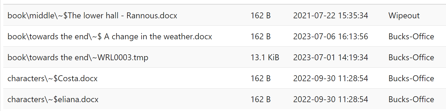

So, there’s a bit of confusion regarding interpreting the list of out-of-sync files on device “Adventure”.
Note that all of out-of-sync items are a week to almost 2 years old. Chances are that all of the items are small enough that they were synced within seconds.
4 of the 5 items were last modified by device “Bucks-Office”. Since those files are being synced from “Bucks-Office” to device “Wipeout”, it doesn’t matter if “Bucks-Office” was offline at the time because the data blocks required could have been – and most likely are – already available on “Wipeout”.
As soon as “Adventure” was reachable, “Wipeout” told “Adventure” about the files. “Adventure” then used a combination of local files and remote files on “Wipeout” to reconstruct the required files.
Patterns in .stignore only apply to files that haven’t already been synced, so you’ll have to delete any undesired files that got thru.
The list of out-of-sync items aren’t necessarily only items that are still sitting on “Bucks-Office” waiting to be sent. When you pulled up the list of out-of-sync items on “Wipeout” for “Adventure”, you were looking at what “Wipeout” needed to do to help make “Adventure” up to date The “Mod. Device” column isn’t referring to which device still needs to send the corresponding file, it’s referring to which device a change originated from (“Wipeout” already knows about and likely has the file in hand).

Your temporary .docx files are a fraction of the size of my blank document. Cropped from your earlier screenshot:
Note that 4 out of 5 of the unwanted temp files are just 162 bytes in size – small enough and old enough for those string of bytes to very likely be found in another existing file. Chances are that those 162 bytes are some kind of stock file header info common to all temporary .docx files.
So as long as Syncthing can find those bytes elsewhere in another file you didn’t delete, it can reconstruct the required files.
You deleted the files from “Wipeout” while “Adventure” was powered off, so “Adventure” still thought it needed those files when it booted back up. Remember that Syncthing can reconstruct missing files with pieces from other existing files, so “Adventure” could sync those files without ever downloading anything new from “Wipeout” (the tiny 162 byte file size makes it extremely likely).
Depending on the order of events and timing, Syncthing can sort things out on its own, but there are niche cases (search this forum for examples) where user intervention might be required because some devices where powered off, conflicts occurred, etc.

But the rest are temp from the actual files which:
~$The lower hall -Rannous.docx temp of 2 The lower hall -Rannous.docx where last worked on and updated on 06/04-2022
~$ A change in the weather.docx temp of 13 A change in the weather.docx where last worked on and updated on 01/07-2023
~WRL0003.tmp no idea as I have removed it from Wipeout completely full delete.
~$Costa.docx temp of Costa.docx where last worked on and updated on 13/07-2019
~$eliana.docx temp of Heliana.docx where last worked on and updated on 14/12-2019
All these makes no sense to me really don’t.
The simplest solution is to create dummy files on “Adventure”, wait at least 10 seconds (Syncthing’s default countdown after detecting filesystem changes), then delete the dummy files.
Because the dummy files have newer timestamps, the versions on “Adventure” will supersede the older ones. Then when the dummy files are deleted, Syncthing will inform “Wipeout” – and by extension – “Bucks-Office” to purge those unwanted files from their respective databases.
So for example, launch Windows Notepad, type something or nothing at all, and save the document as ~$eliana.docx (placing it exactly where the location of the out of sync file is).
It doesn’t matter it you use Notepad and/or create a real .docx file. It only matters that there’s a matching file for Syncthing to process.
If it were me, I’d use the echo command because it works the same on Windows, macOS, Linux and Android:
echo > C:\Users\owner\Documents\characters\~$eliana.docx
The sample command above creates a text file with just a newline character. Syncthing doesn’t care that it’s not actually a Word document.

Seems like doing the echo thing and then remove the .stignore rules temp on Wipeout/Backup and then putting them back and removing the files on Adventure and Wipeout fixed Adventure showing as syncing.
I got on the Bucks-Office and saw it was complaining about the files, but the second I added the .stignore it went yay Wipeout is now up to date, so everything is green and up to date.
