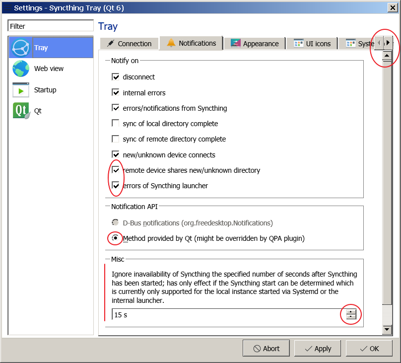

Not on my system:
as you can see, Qt5 rendering is almost identical to the native one. But Qt6 contains some artifacts:
some lines are missing, elements that should be identical are different, up/down and scrollbars look very strange.
Thanks for your feedback. Unfortunately I can not do much about these issues and my knowledge of Qt’s internals and changes of Qt 6 is also limited. I mainly asked for feedback to decide which Qt version to use for my binaries. For now I decided to keep using Qt 5 and add Qt 6 based binaries only additionally.
By the way, I’ve also noticed a slightly different font rendering when testing myself under Windows 10. What you describe as “bold” looks like anti-aliasing to me but it really doesn’t look very good in your case.
I’d also like to note that the latest Qt 5 and Qt 6 based binaries are linked against the exact same versions of FreeType2 and Harfbuzz (and any other dependency). My own code is also almost identical. So I really suspect the Qt version makes the difference here. Maybe also just some default settings (which my code doesn’t touch) have changed.

I could reproduce the glitches under Windows 10 and also under X11/Linux when setting the environment variable QT_SCALE_FACTOR to a non-integer value like 1.25. And it is only reproducible when using Qt 6. So likely the different default for the rounding policy in Qt 6 makes indeed the difference here because Syncthing Tray simply uses Qt’s default here.
In Qt 5 the default could be overridden by setting QT_SCALE_FACTOR_ROUNDING_POLICY=Round|Ceil|Floor|RoundPreferFloor|PassThrough but judging by the documentation that’s no longer the case for Qt 6 (compare https://doc.qt.io/qt-5/qguiapplication.html#setHighDpiScaleFactorRoundingPolicy with https://doc.qt.io/qt-6/qguiapplication.html#setHighDpiScaleFactorRoundingPolicy). However, judging by the code it is actually still possible.
I’ve also just tested it on Linux but it didn’t make much of a difference. In fact, regardless of what I set QT_SCALE_FACTOR_ROUNDING_POLICY to I’m getting the same rendering issues. However, the environment variable seems to be parsed at least, e.g. I’m getting Unknown scale factor rounding policy: loor. Supported values are: Round, Ceil, Floor, RoundPreferFloor, PassThrough. if I pass a wrong value.
Bingo! QT_SCALE_FACTOR_ROUNDING_POLICY=Round removes all glitches. QT_SCALE_FACTOR=0.8 (0.8*1.25=1.0) also removes them, but UI is too small.

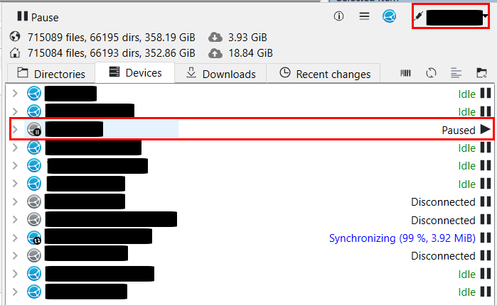

I am not sure why, but recently (maybe after upgrading to Syncthing 1.13.x?), I have experienced a strange problem.
Basically, my own device is being shown as “paused”.
This has happened quite a few times, so it seems to be some kind of a bug, but I am not sure how to debug this. Obviously, everything seems fine in the actual Syncthing Web GUI. Also, only one configuration behaves this way, while the other ones all seem to be working fine.
Trying to “resume” in the Syncthing Tray does nothing though. The device seems to stay “paused” permanently (even though in reality it is working just fine).
I am using Syncthing Tray (Qt 6) v1.1.2.

Unfortunately, there is no difference :slightly_frowning_face:. The device is still listed as “paused”. One thing that I can also add is that the tray icon seems to periodically switch from grey to blue back and forth, but the status remains “paused” regardless.
Edit: In the meantime, I have tested the Qt 5 flavour of v1.1.2 too, but the problem is still there.

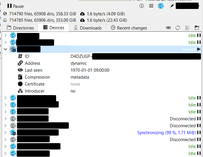

Does the ID shown for your own device within the list of devices match the ID shown for your device when you click on “View own device ID”?
By default the overall status is “paused” when at least on device is paused. You can disable this setting as a workaround to avoid the overall status being affected.
The ID is correct, but the last seen date is kind of suspicious.
I have just done it :+1:. Just for the record, I have no actual devices paused in the Web GUI. It is just Syncthing Tray that marks the “own device” as “paused”.
In both cases, including the “View own device ID” dialog?
I can reproduce the wrong/meaningless “Last seen” date here as well. Not sure whether that was always the case. Note that this date is passed as-is from Syncthing’s REST-API which apparently sets that value for the own device. Maybe I should treat that data as null-value or simply ignore the data for the own device.
Interestingly the official web UI shows “Never” as last seen date for one of my devices although the API correctly returns “2018-05-03T16:29:29.594912942+02:00”. Syncthing Tray shows as always the value from the API as-is. I’m wondering whether it makes generally sense to have a threshold like the official web UI (whatever that threshold exactly is).
I suppose it is actually impossible to pause the own device. That Syncthing Tray displays the own device as paused is definitely just a displaying error on my side and should never occur regardless of your settings.
