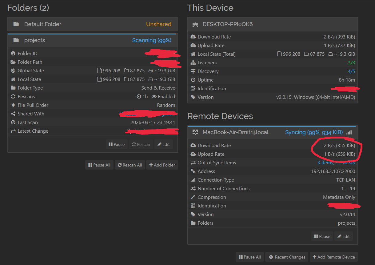

Why is the download and upload speed so slow?
Because.
You have a million files with an average size of 19kb each. And the source is scanning. This isn’t about transfer data rate. It’s about scanning performance and the “many small files” problem.
There’s quite a bit of discussion about it. But the real performance question you should concern yourself with is based on the number of files and folders. Not so much with the data rate.
