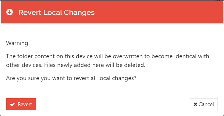

Seeing the files in said folder being recognised but not understanding yet why things weren’t syncing between computers, I ultimately chose to press the red “revert changes” button, not fully understanding the function or implications of the warning. I saw the folder size swiftly reduce, and very swiftly my files were gone. So incredibly fast.

That button shows up when you set a folder as “Receive Only” and then change it locally, as changes in “Receive Only” folders aren’t supposed to be synced with the rest of the cluster.
The “Revert Local Changes” button undoes everything you changed in your folder.
If you created files, it deletes them.
If you modified existing files, it undoes those changes.

Are you using a very old version of Syncthing by any chance (e.g. one that comes from your Linux distribution’s repository)? I’m asking, because normally, there is yet another pop-up displayed when you press that button, with a more detailed explanation of what is going to happen if you continue.
