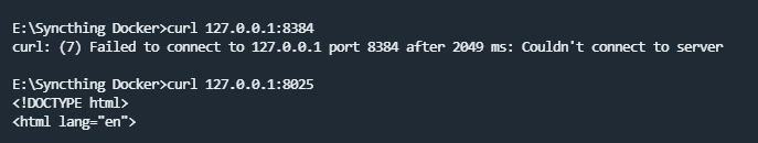

I can modify the settings to add the Windows instance and my cellphone, and I can even use curl on other containers and even on my Raspberry Pi.

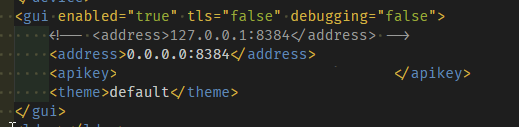

I tested curl on port 8384, and it worked. I also tried changing the port in the .xml file and tried again, and it worked too.
I could use it by just editing the .xml file, but you know, adding a folder would be such a hassle instead of just clicking “accept.”
Since cURL is able to access Syncthing’s web GUI, what doesn’t work? Did you mean you get an error in a web browser?
Sorry, I expressed myself poorly. I can use cURL from within the container to the outside, but I can’t do it from outside to inside.
The first one is the port of Syncthing, and the second one is another container.
Ah, no problem. In the Syncthing container, what is the output from the command ufw status?
And from the Windows host, does netstat -an show a process listening on port 8384?
Port 8384 does not appear in netstat.

Did your previous YAML file include port binding declarations? e.g.:
ports:
      - 8384:8384
Or did you set it as a start up option?
Oh my god, I understand what the problem is now. I had tried setting the port before and still couldn’t connect. Then I tried without specifying the port in the YAML file, and I didn’t realize that in the .xml configuration, for some reason, it was set to 127.0.0.1.
And when I changed it to 0.0.0.0, I didn’t realize that I also needed to specify the port again in the YAML file.
Thank you for your help. As usual, user error (? I assume he should have set it to 0.0.0.0, I don’t know why he didn’t).
It must have been manually changed to 127.0.0.1. Since the YAML file declares image: syncthing/syncthing:latest, it would have reverted back to the default of 0.0.0.0.
With --network host and network_mode: host, the container’s network interface is mapped to the host’s. The net effect is that network services in the container are accessible without explicitly binding ports inside the container to the host.
If Syncthing’s config.xml has <address>127.0.0.1:8384</address>, on the host side Syncthing’s web GUI would be accessible at http://127.0.0.1:8384/. And if it’s <address>0.0.0.0:8384</address>, on the host side it would be accessible at http://0.0.0.0:8384/ (perhaps open to the rest of the LAN the host is connected to depending on the host’s firewall settings).
Or in other words, if the YAML file declares this…
network_mode: host
… port bindings aren’t needed:
ports:
	- 8384:8384
But if host network mode isn’t used, then port bindings are required for access outside of the container.
