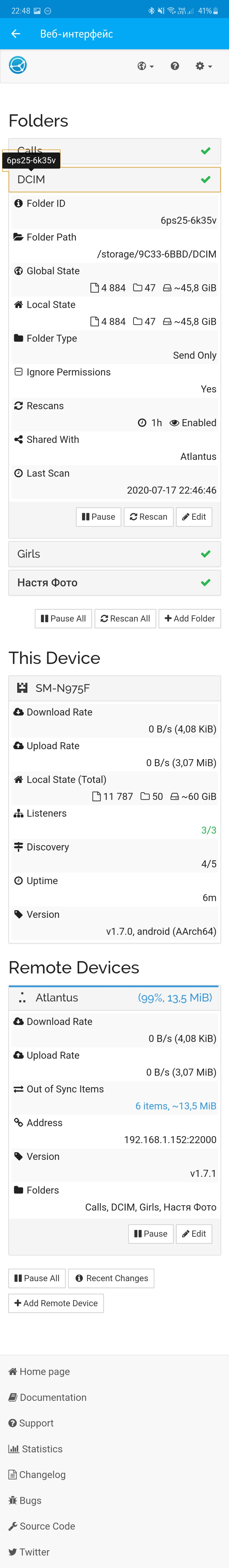

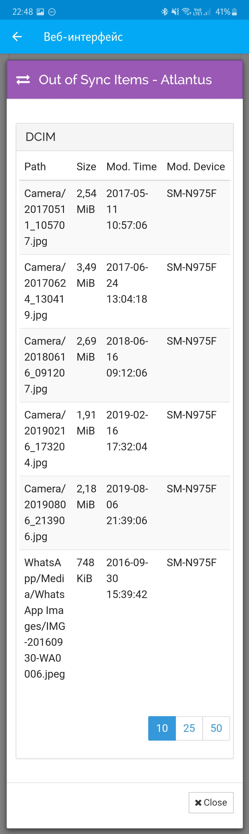

Another strange behaviour I’ve got here, set up DCIM folder sync from Android 10 device with a whole bunch of files. It made a full sync up to date, but now I’ve got out of sync state on receiver with 6 pics. Checked the receiver and all 6 of them are there. Stopping/restarting won’t help on ether side.
Here are some screenshots taken on sender.

In this specific case you are looking at a remote device. We would not log remote devices sync failures locally (errors is not something that travels across the network), you have to check the logs/ui on the other side.
The screenshots are from client side and out of sync file list is missing error description column in web-ui. This one is definitely present in mac os web-ui, it helped me to fix ‘Long filename’ issues. Maybe it’s specific to Android, or there’s no error description to show in my particular case.

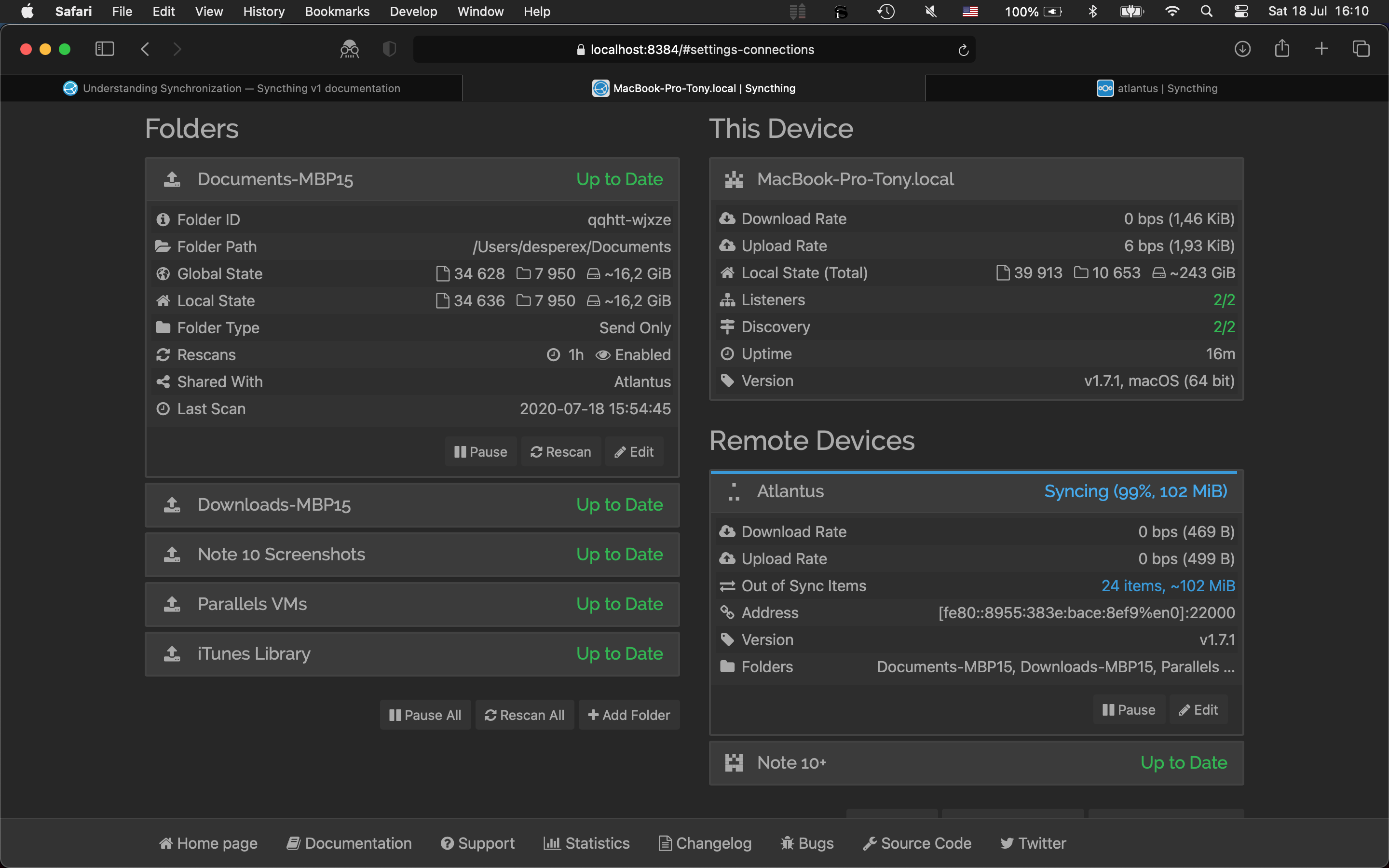

Another out of sync, local is mac os, remote is the same. Local is exposing send-only Documents folder, remote is catching it un receive-only mode. This is local, that says 24 items are missing on remote, and it’s true, they all belong to Documents folder:

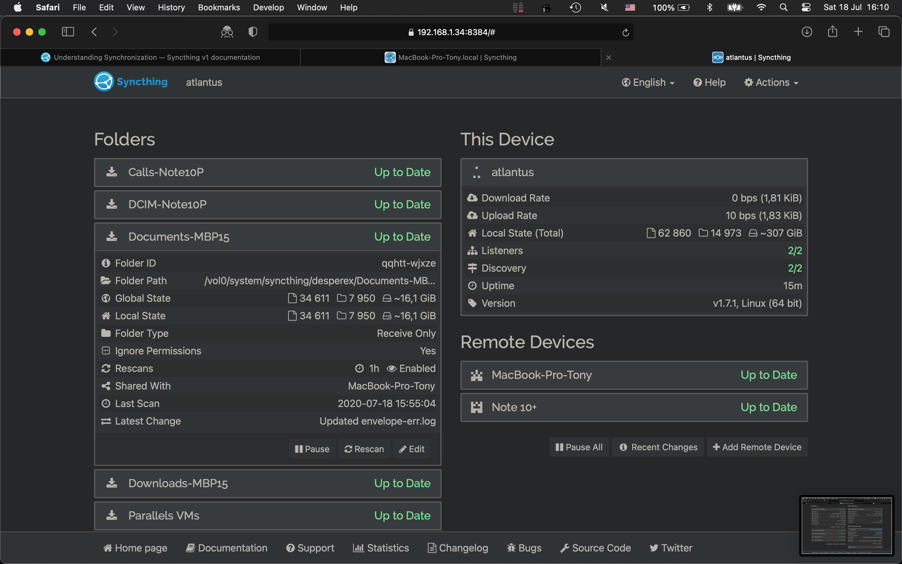

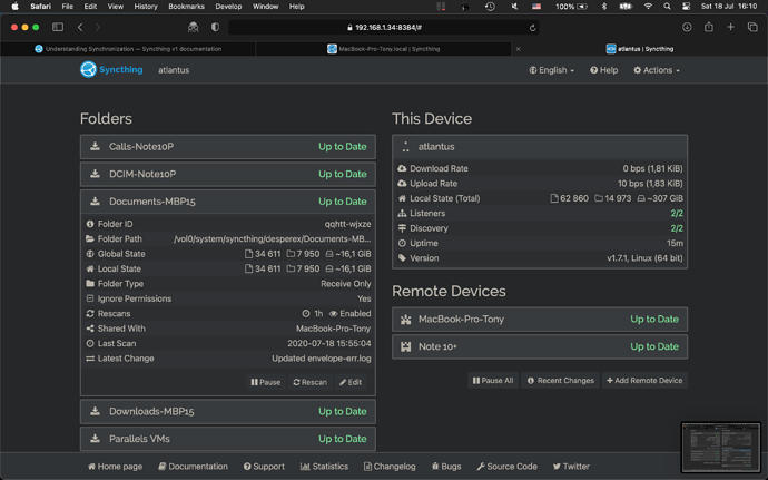

And this is remote:
So why all item numbers do not match? Local says it’s 34628 (global) and 34636 (local), but it doesn’t match 34611 (local/global) on remote. And if out of sync info on local is correct, it should be 34611+24=34635 files on remote…
What went wrong and where to take a look?
UPD: Deleted database on local, now all parties got 34628
