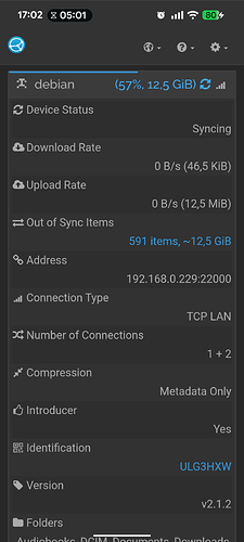

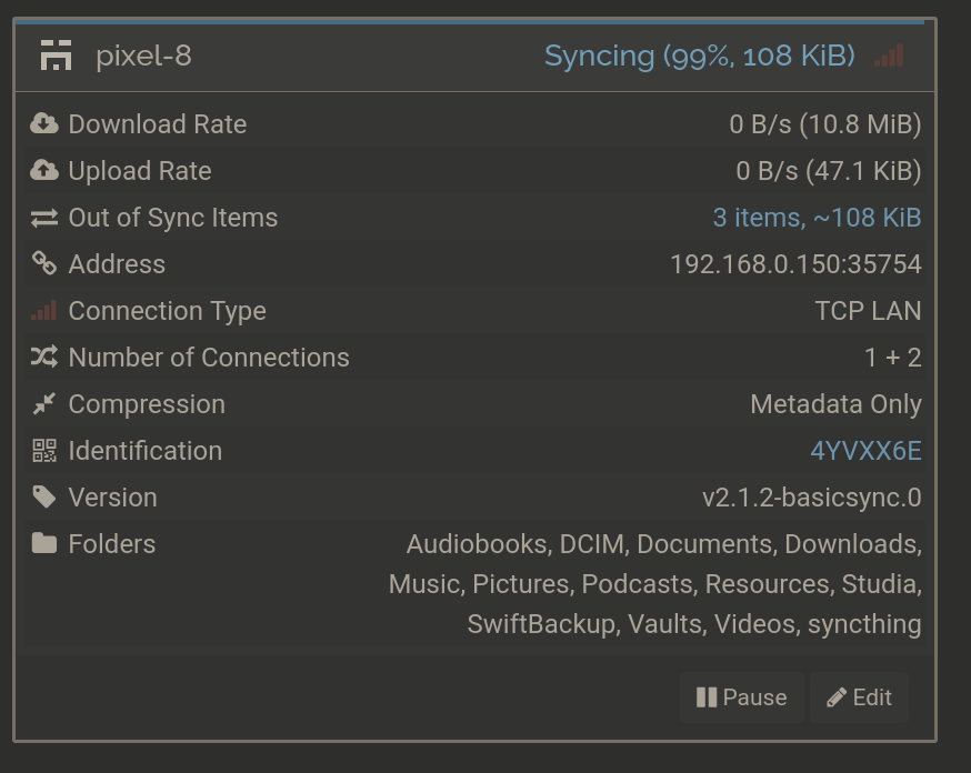

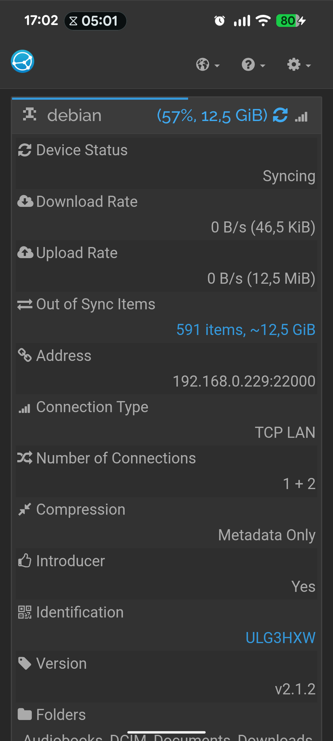

Can you show screenshots of the Syncthing web GUI from both sides? On Android, you can access the web GUI from the left slide-out menu. Before taking the screenshots, olease unfold the information under the relevant remote device.

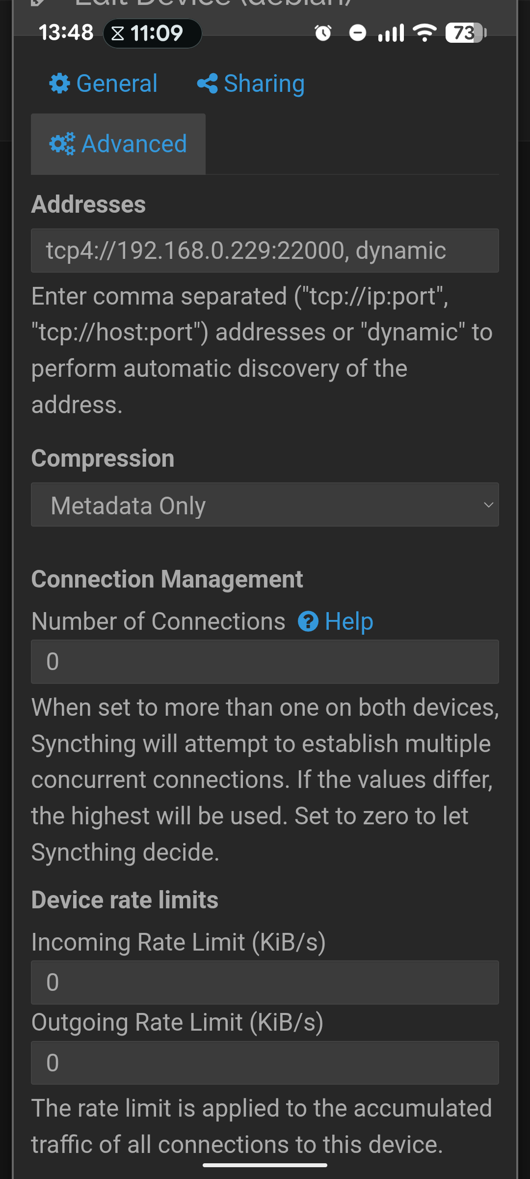

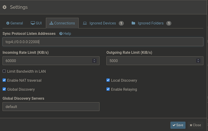

Cheer1
August 10, 2026, 12:00pm
17

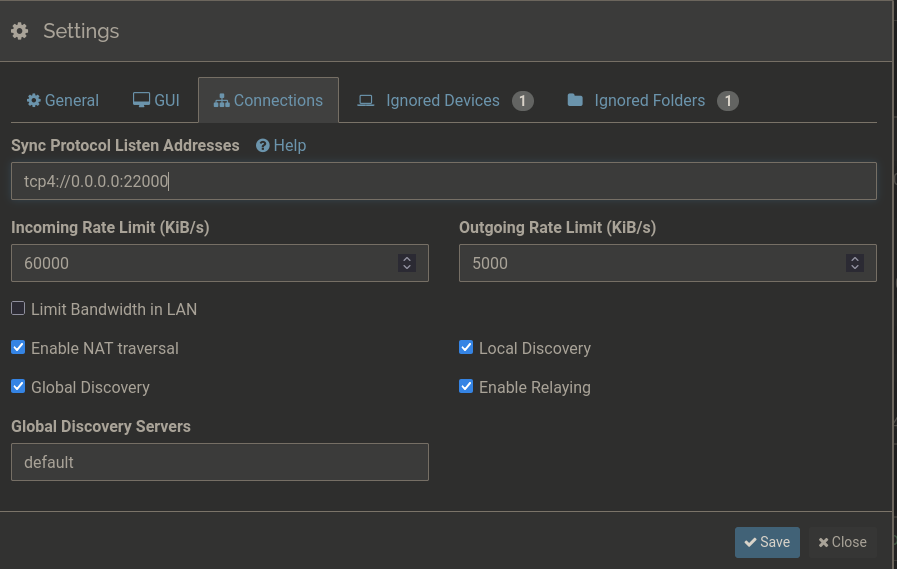

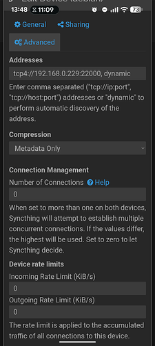

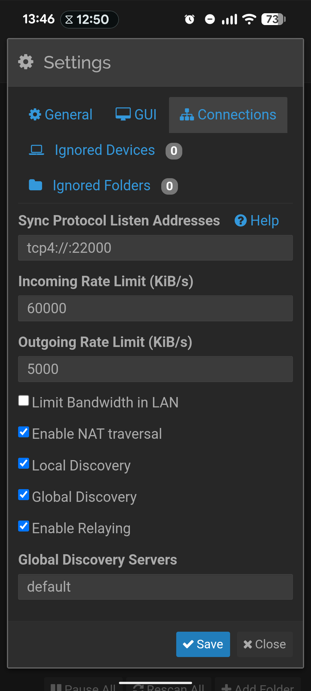

Hi, I’m still struggling to get the right setup. Can someone please have a look at my connection options? I want to make sure everything is right on this level before delving deeper.
I use tcp4 because IPv6 addresses are dynamic and it causes unstable connections. I enabled Global Discovery and Relaying in order to sync my files on any other network that is not my LAN , did not set a limit of bandwidth in LAN because there is a lot of bandwidth available.
In the Device > Advanced I set “dynamic” assuming that if the peers don’t successfully connect via tcp4 they will connect in any other way. Is this how it works? I tried to set the number of connections to 1 but that didn’t help, so I changed it back to 0.
Settings > Connections
Device > Advanced
