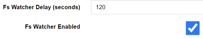

Have you tried Fs Watcher Delay (seconds) in the Advanced Configuration? Syncthing by default waits for 10 seconds before pushing the changes. You may want to set this to a higher value, e.g. 60 seconds.
For this specific use case though, I think that you may need to disable periodic scanning also.

I would try using these settings and keep observing the situation closely for some time to make sure that all the files are synchronised as supposed.
