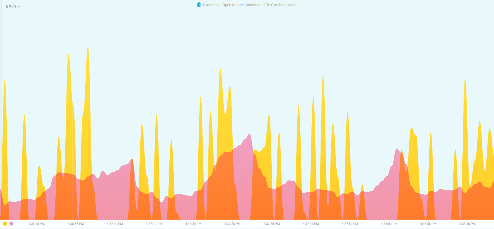

Very inconsistent transfer rates.
Any ideas on what could cause such irregularities in transfer speeds?
At the time, I was sending one and receiving one file. Pink is upload, yellow is download.
I’m just a casual user, using Syncthing to share files with a friend living far away from me, so I don’t have the access to the other device.
I can only say that both devices are on wired connection, and these kind of irregularities don’t happen elsewhere (e.g., uploading video to youtube or downloading file from cloud service).
Remote device:
Direct TCP connection over WAN
tcp-server TLS1.3-TLS_AES_128_GCM_SHA2 56
Syncthing is mainly limited by CPU and disk IO. Just because your network bandwidth is not saturated does not mean you are not saturating something else.
It all depends on how the graph would have to look for it to seem “regular”. :wink:
But on a more serious note…
The pink/upload graph relative to the yellow/download graph looks fairly normal to me. While more expensive business internet connections are frequently symmetrical (i.e., same download/upload speeds), home broadband is more likely to be asymmetrical with downloads being multiple times faster than upload speeds.
Asymmetric download/upload speeds results in the yellow/download graph being more “spiky” because less time is required to download each network packet. In contrast, the pink/upload graph looks more like the silhouette of a mountainous ridge because each network packet transfer is spread out over a longer period.
However, the graph only covers a 88-second window of time, which isn’t really enough to discern any kind of real trend or even diagnose a potential ongoing problem.
Syncthing dices up files into blocks and avoids resending duplicate blocks so the time to transfer a single file isn’t necessarily going to be linear (i.e., file size divided by network speed). A number of factors affect transfer speeds, including, but not limited to:
  • The system resources of each device. Devices with more CPU horsepower will be able to compute the required hashes faster.
  • Number of interconnected devices sharing a Syncthing folder. The more devices there are, the more that transfers can be done in parallel between multiple devices.
  • File types being synced. Files with higher probability of overlapping blocks require less time than highly compressed files such as audio and video.
  • Operating system.
  • You didn’t mention what your and your friend’s download/upload speeds are, what type of broadband connection it is, etc.
YouTube and a cloud storage provider are very different from Syncthing in terms of uploading and downloading. For the former, a few of the biggest factors are:
  • The transfer protocol is simple HTTP/HTTPS.
  • Doesn’t usually involve chunking files into blocks to look for redundancies.
  • YouTube and other cloud service providers make use of multiple high-powered servers, internet connections, and often a CDN service.
In comparison, you’re downloading/uploading from a single server without a boost from a CDN.
The configuration tuning page in the Syncthing documentation has tips on improving performance for a given environment. But keep in mind that if your friend’s computer is 10 years old and/or his network connection is slow, has high latency, etc., it won’t matter how fast your computer and network connection is.
There have also been quite a few forum threads regarding transfer speeds and ways to diagnose and improve them. In particular, search for posts mentioning iperf.
If I zoom out enough…It looks pretty regular :laughing:

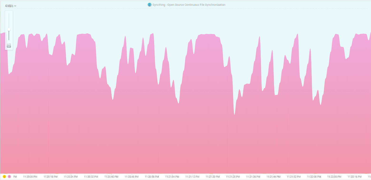

To be clear, my upload speed is pretty slow (~3MB/s), so I didn’t expect any crazy speeds, but on that graph(y axis goes to 6MB/s), my upload speed hasn’t reached 3MB/s even once, and for the majority of the time, it’s bellow 1.5MB/s. I do understand dips but it seems like there are more dips than there are peaks.

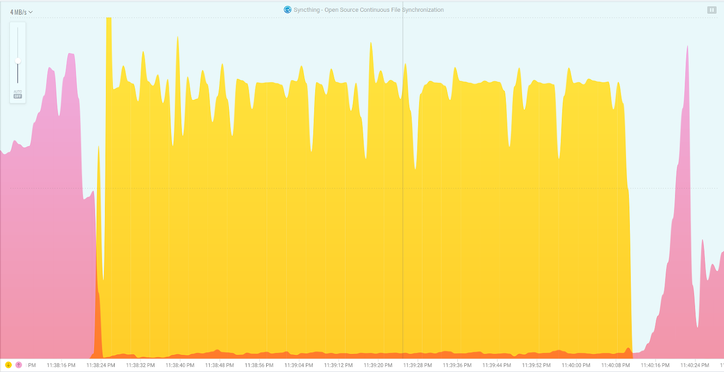

And when I download file from my friend (yellow) that’s just super weird, I don’t understand why it peaks so sharp and there are such big pauses where speed is basically 0. Even those peaks barely reached 4-5Mb/s, even though my friends upload is is 150Mbps and my download is 300Mbps.

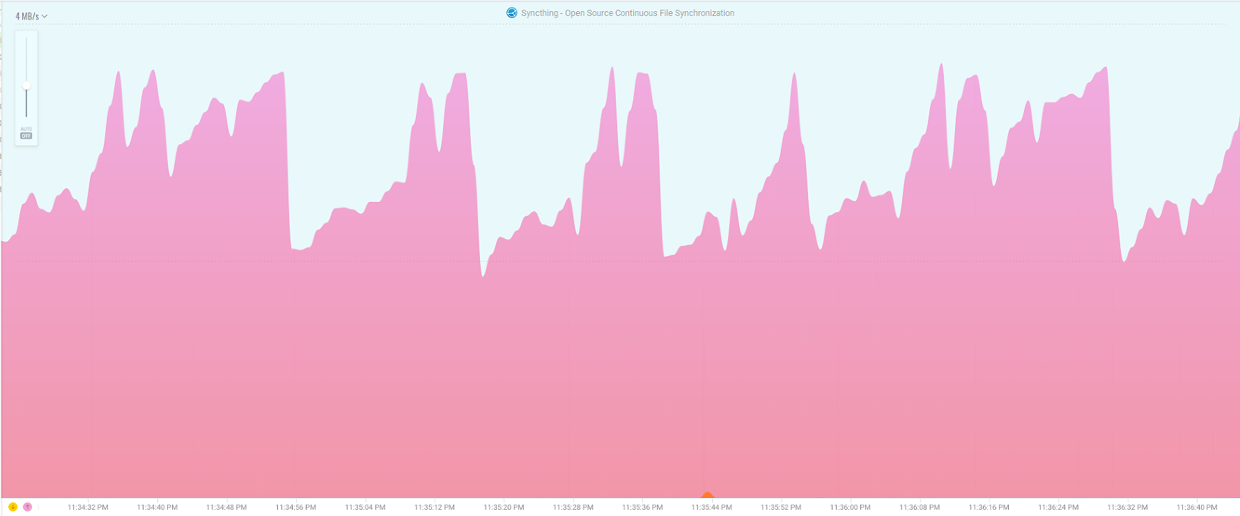

I tried transferring the same file with Syncthing on my cheap phone connected to a WIFI, connected to a free VPN.
And I got much better results. Transfer speeds were reaching my upload cap, and dips were sharper and shallower. So the average speed was much better overall.
And then by doing nothing other than pausing and unpausing the folder shared with my friend, transfer speeds between us also started looking better. Weird.
The next day I again tested the theory with pausing/unpausing the folder, and it seemed like it helped again, but after some time it would go back to looking like the first graph…
I can’t say anything for certain. I will play around with stuff, and if I find something out, I will write an update.

There appears to be a roughly 20 second window where the speed gradually rises before it falls.
