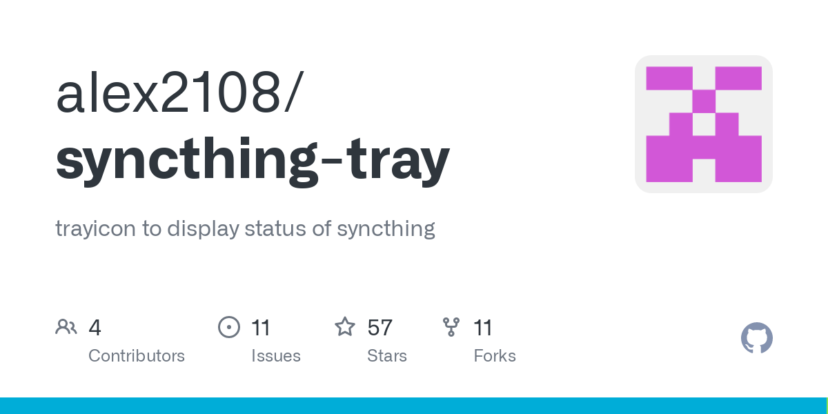

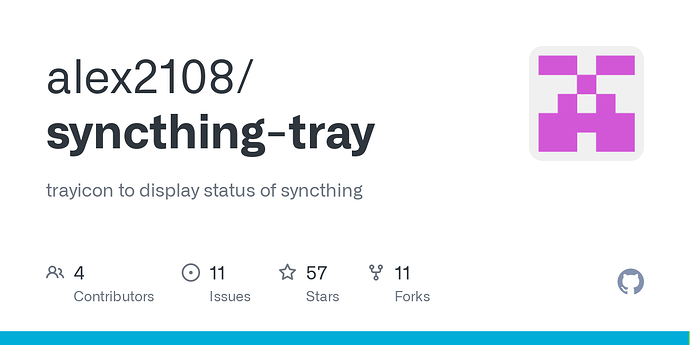

syncthing-tray.exe
Where did you download this file?
