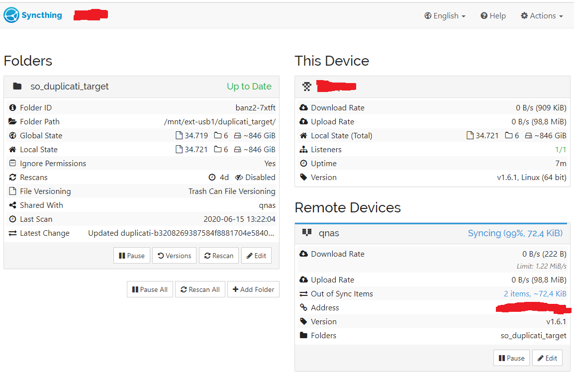

I’m currently on v1.6.1 with an SO>SR Duplicati “backup” cluster where SO sends to SR periodically while Duplicati is not running.
SO, device A:
SR, device B:
If I click 10 items on B, nothing shows up.
I’ve restarted Syncthing on both nodes, clicked “Rescan” and waited a while, but nothing else changes or happens.
Btw: I’ve already checked device A’s ignore patterns and don’t see any mistake. I’ve ignored one folder (months ago on v1.5.0 already) because I don’t want it to be synced over to the target and the target doesn’t have this folder.
Which logs should I grab next?
Thank you.
Kind regards Catfriend1
Ignores are likely not the culprit here, that’s been a consistent problem ages ago but I can’t actually remember any recent issues with ignores.
The numbers not matching the list of items in the modal points at a mistake in the new “need accounting”. That stores the numbers of needed files for efficiency, separate from the storage of the actual needed items (the latter hasn’t changed). Unfortunately that’s super hard to debug without a reproducer, as it’s just a few cumulative numbers that are wrong, no history or even just which files are involved is visible.
When you click on the 6 out of sync items on A, is the modal empty too?
Thanks for all the investigation. The db wouldn’t help me, as I don’t know what to look for. It’s clear that despite the fixes until v1.6.1 around sequences, there’s still ways for the db to get inconsistent - no clue how though.
