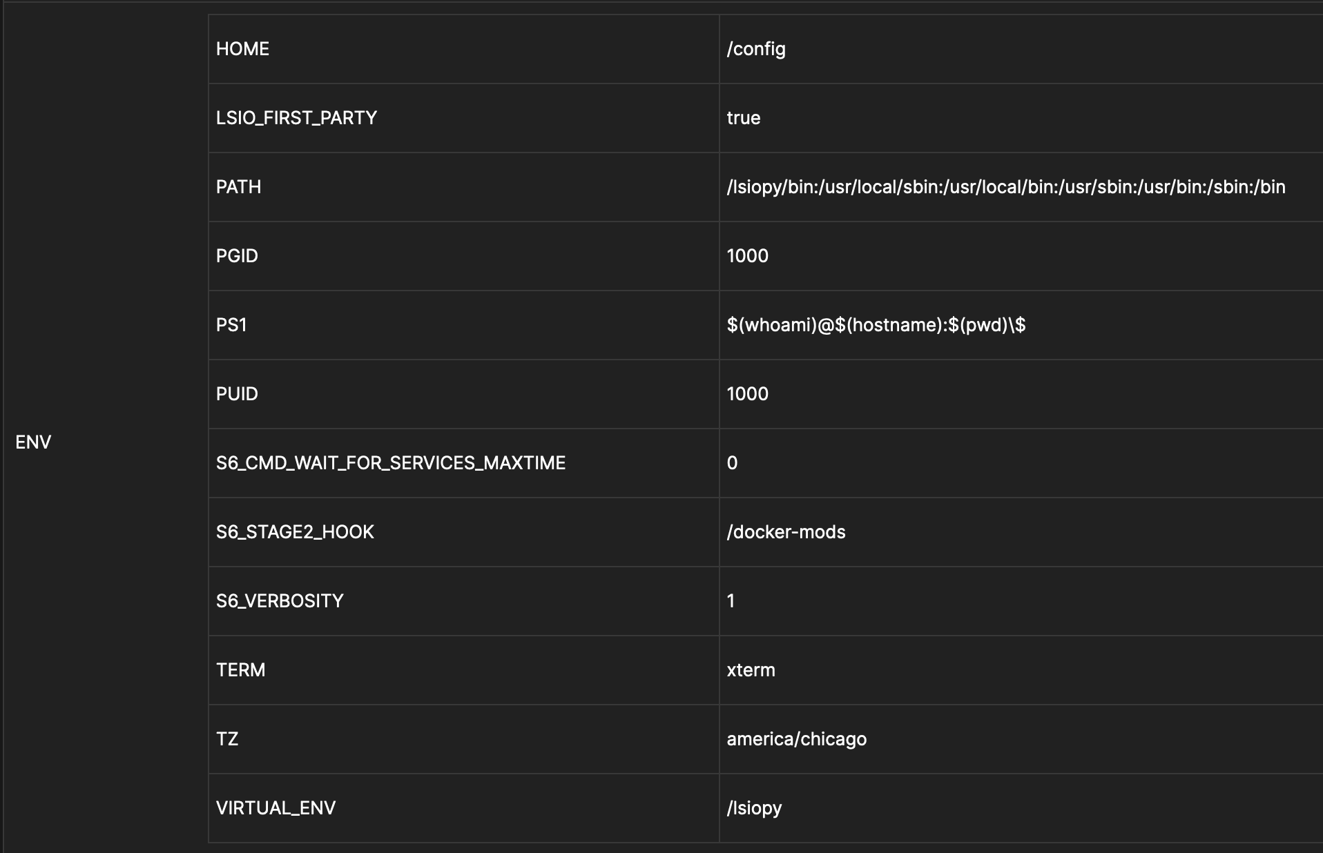

From your description and screenshots, it’s very likely that the user:group (or more precisely, the UID:GID) of the user running Syncthing inside the container doesn’t match that of the user and group garfield:garfield on the Ubuntu host.

on portainer I’m using the linuxserver latest channel Linuxserver.io version:- v1.27.6-ls138 Build-date:- 2024-04-09T09:12:04+00:00
for giggles I 777’ed the mounted USB drive and it didn’t work either.
I’ve confirmed that portainer is assigning it PUID/GUID of 1000 (which i’ve confirmed is the correct ID for the garfield user)
