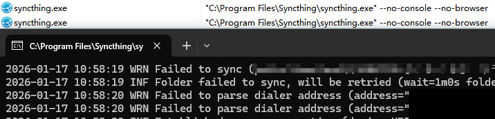

I’m using 2 instances scenario. And I faced with even if I run 1st instance with “syncthing --no-browser --no-console” and it usually closes the window (even I saw it may not close sometimes), second instance command “syncthing --no-browser --no-console --home=%LOCALAPPDATA%\” does not close the console window
I found one of solutions: the usage of “conhost” ( -no-console option does not work when Windows Terminal is set as Default Terminal application · Issue #8046 · syncthing/syncthing · GitHub ) and it works just fine

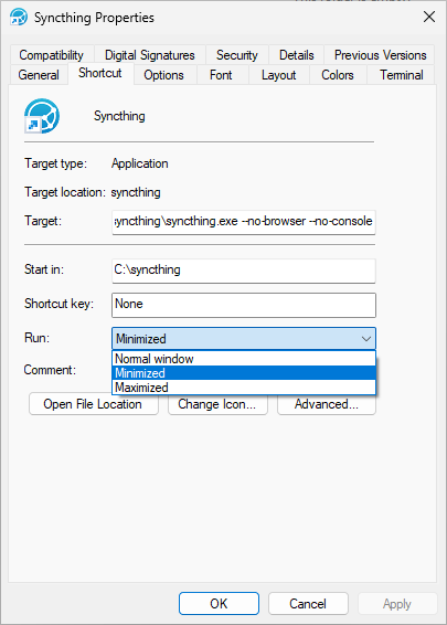

I just added a second shortcut to Startup with different --home and rebooted: no Terminal window. I set Start window: Minimised for the shortcut.
Workaround by @cosas
For me run: minimized had (still has, as long as I’m not a usual Windows user) the merit of completely hiding the console. --no-console does its own job OK (--no-console all alone, the console won’t even show as a stable terminal application button in the task bar) and run: minimized just prevents the stealth window/button on startup… all fine… for me with single instance… in friends computers.

--no-console parameter does not take effect on computers with Windows Terminal installed, resulting in persistently lingering windows. The --no-browser parameter has always worked as expected. There is no order dependency among the launch parameters passed to the application. By convention, if there are spaces within a parameter, quotation marks must be used to specify the start and end positions of the parameter. This is why the file path in shortcuts is enclosed in double quotes by default—because Windows allows spaces in directory names. If there are no spaces, the presence or absence of quotes does not affect the execution. Moreover, if the parameter itself contains quotes, I used single quotes and backticks to escape the quotes to avoid ambiguity and prevent incorrect parameter termination. This code has been repeatedly tested on my computer at the very least. If you’re not clear about how the --no-console parameter behaves on my computer, I can attach a screenshot to help clarify.
Windows Terminal has taken over and replaced the default Windows CMD.exe, altering the expected behavior of cmd.exe. If you simply set the shortcut to minimize, a Windows Terminal window will always remain on the taskbar. Once you close the window or the Syncthing tab, Syncthing itself will also shutdown, resulting in the --no-console parameter having no effect at all (as discussed in the GitHub link at the top of the post). If you revert CMD to its default settings within Windows Terminal, you lose the convenience of using Windows Terminal to aggregate CMD and PowerShell windows. In other words, as tomasz86 mentioned, I don’t want to switch back to the old-fashioned CMD shell just because the Syncthing window can’t be closed. Managing Syncthing through the Task Scheduler every time is too cumbersome. What I want to achieve is a solution that allows me to “place a shortcut on the desktop for easy access, put it in the Startup folder for automatic launch, avoid modifying Windows Terminal’s window settings, and not worry about the security risks associated with excessive System user permissions”.

I’m getting different results - tested on 24H2 and 25H2 with WT as default:
--no-console Run Window
- Normal Windows Terminal
- Minimized Syncthing
+ Normal WT (minimized)
+ Minimized -
In the last case it is a background process in Task Manager.
