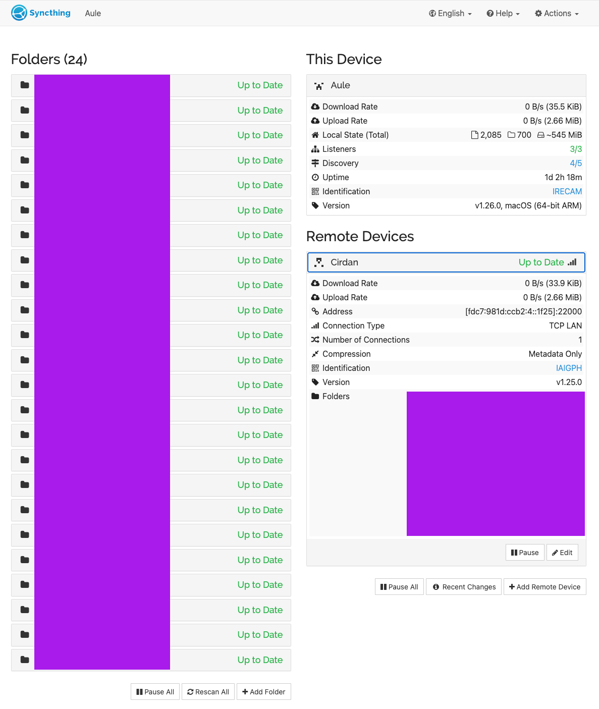

On Aule, I see this on the web control panel:

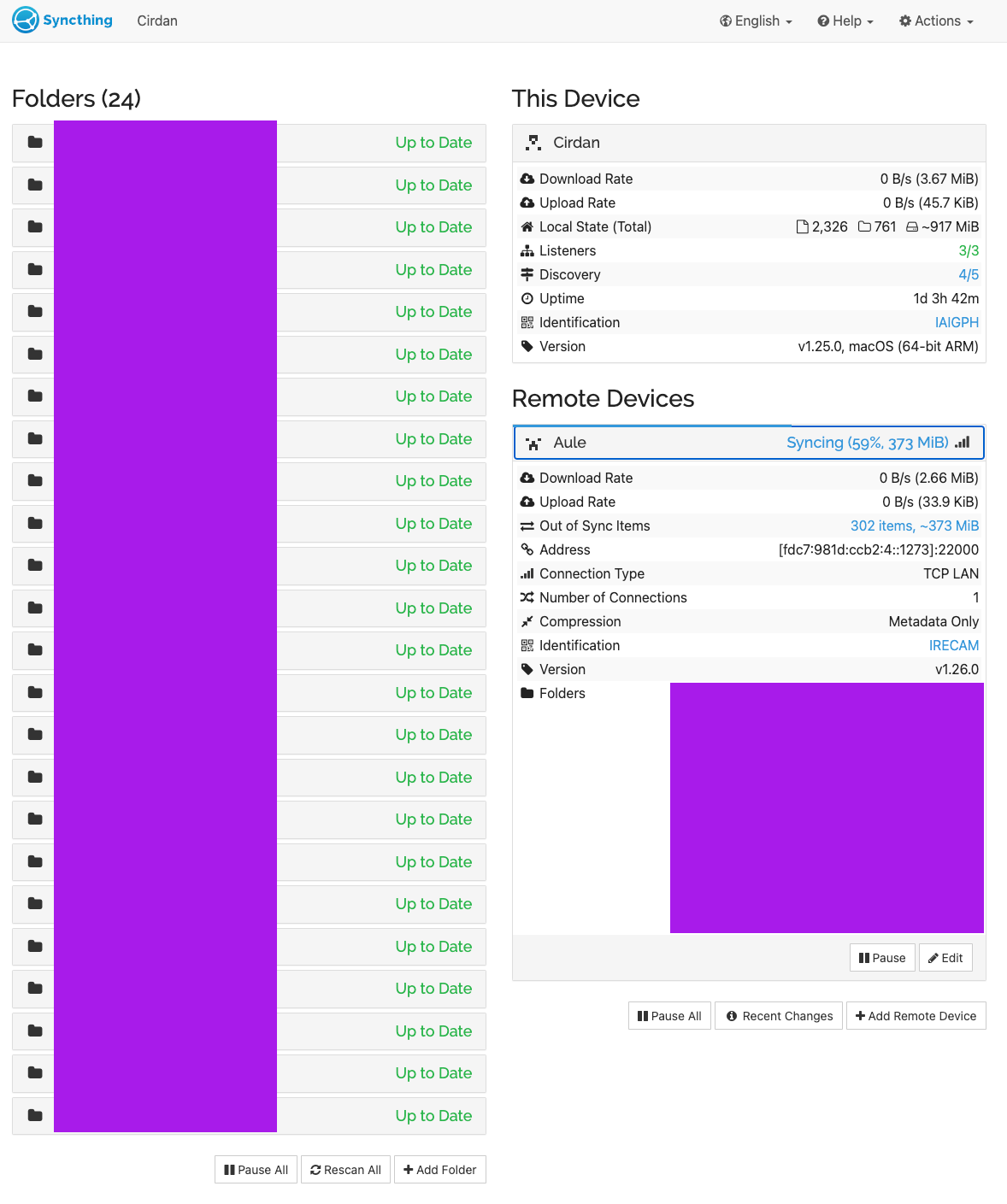

It reads as having updated Cirdan with everything. Here’s the control panel on Cirdan:
This has been the situation for over a day: Cirdan reports Aule as only 59% updated. I’ve restarted both systems multiple times, but there’s no change. It seems that Aule is just not getting updated from Cirdan. On each share, I created it on Aule, then went to Cirdan and accepted it as a share.
What’s going on here and what do I need to do to make sure both stay fully updated with each other?

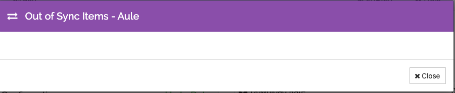

On device “Cirdan”, take a look at the list of out of sync files by clicking on the blue hyperlink labeled “302 items, ~373 MiB”.
It’ll open a pop-up window that lists the items. If the error is to long, it’ll be truncated, so hover the mouse pointer over the item to see the full message.
This is all I get:
No text or anything, just the blank pop-up. (Looks like I cut out the very edge of the pop-up on the left, but there was nothing there.)
Looks like a bug, but unfortunately it’s impossible to know what has lead to this state. If you use --reset-deltas (see https://forum.syncthing.net/t/transfer-at-0-bytes-a-sec/21002/12), the erroneous Out of Sync Items should go away.
