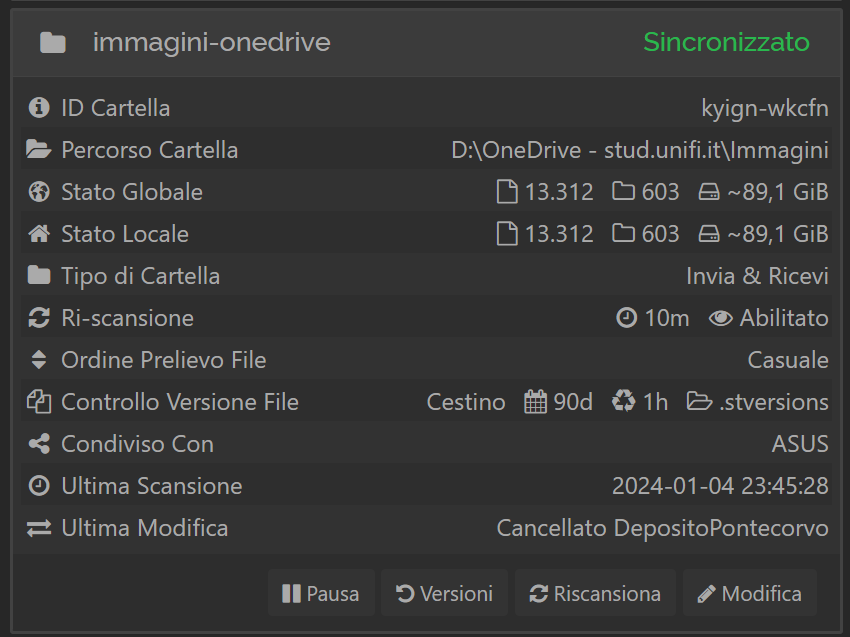

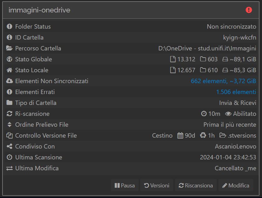

Let me briefly explain my problem: I tried to sync a folder I have on onedrive from a laptop B to another pc A that I use as a desktop pc. The problem is that the synchronization turns out to be incomplete on the latter (A). the folder window shows unsynchronized items and in greater numbers incorrect items.
pc A
pc B
clicking on “erroneous elements” I see the following description (I think the same for each element, but I can’t verify one by one because there are 1506 elements).
hashing: opening \?\D:\OneDrive - stud.unifi.it\Immagini\...\ "namefile".ext: Access to the cloud file is denied.
syncing: finishing: checking existing file: file modified but not rescanned; will try again later

You’re not trying to sync the files using both Syncthing and OneDrive simultaneously, are you? I mean a situation where both Syncthing and OneDrive are installed on two PCs and trying to sync the same files between them. On the other hand, if you’ve got OneDrive installed on one PC only, and then try to sync the files with other PCs using Syncthing, then that should work fine.
Regardless of the above, the error message saying that “access to the cloud file is denied” means that despite your settings, OneDrive has actually not downloaded the files locally, and they are still stored in the cloud only, hence they aren’t accessible to Syncthing.
