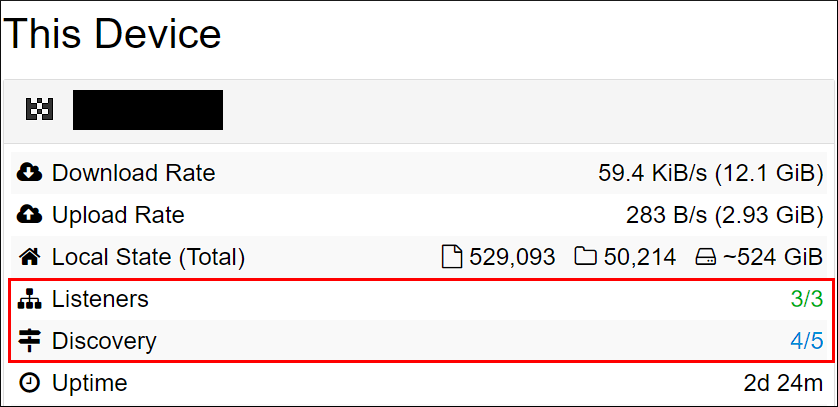

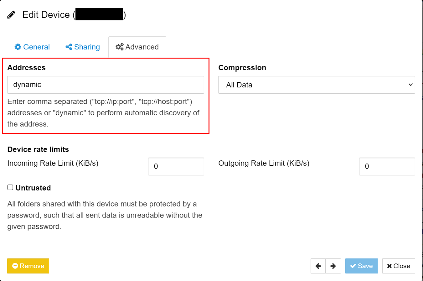

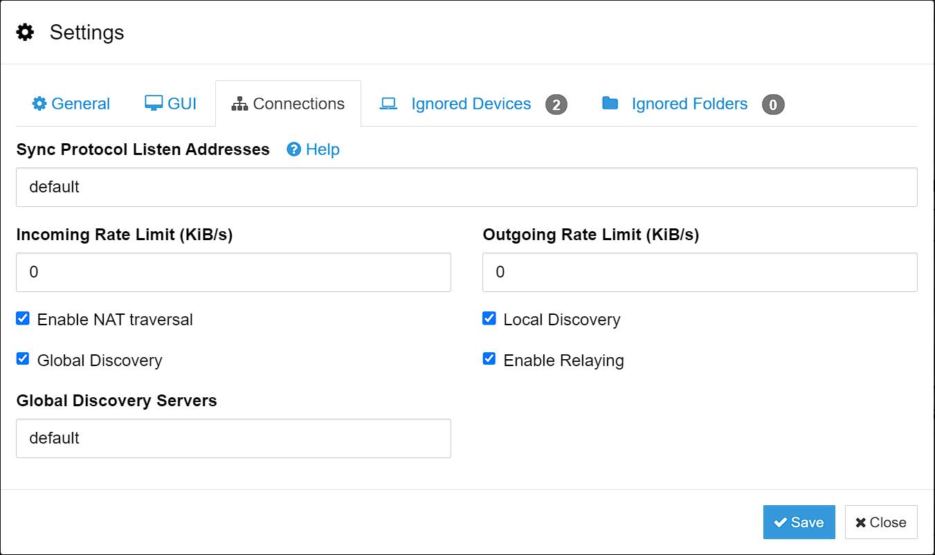

Can you try to revert all network-related settings in Syncthing to the defaults and see what happens? By the defaults I mean this in the general settings:
and this in each device’s settings:

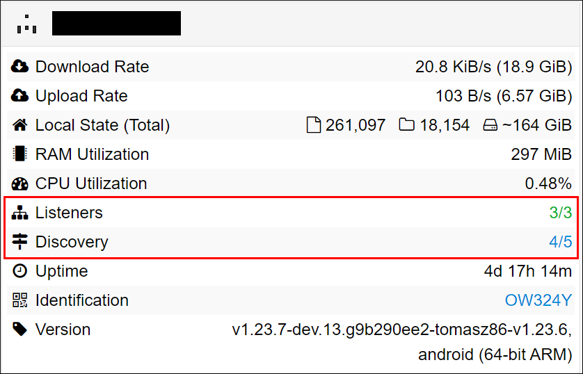

After doing so, please post screenshots of the Syncthing WebGUI on both sides. On Android, you can access it from the left slide-out menu (or remotely on a larger screen if you know what you’re doing). I’m also assuming that Syncthing is still running as root on the Android side.
When it comes to the Web GUI, I’d basically like to see this part:
If the numbers are different (i.e. not all listeners and discovery work), please click them and post screenshots of any error messages logged there.

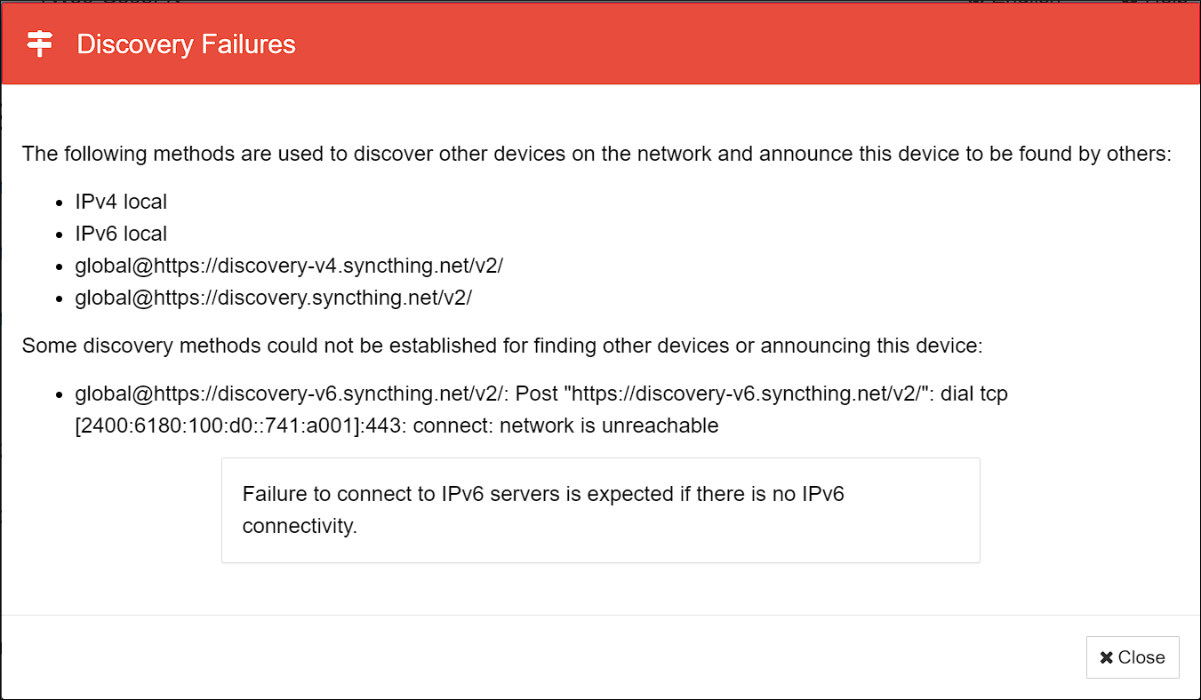

This is with all settings on default for both the phone and PC (except Global Discovery and Relays disabled). I’m following the steps of the alternate workaround where I reserve a DHCP address for one device (PC) then add it to the phone. The discovery failures are to be expected as I do not have IPv6 enabled.
The setting the docs refer to is called “Enable NAT traversal” in Connection Settings. It’s enabled by default though.
UPnP isn’t relevant if you’re not talking through the NAT though, e.g. if your devices are on the same network.

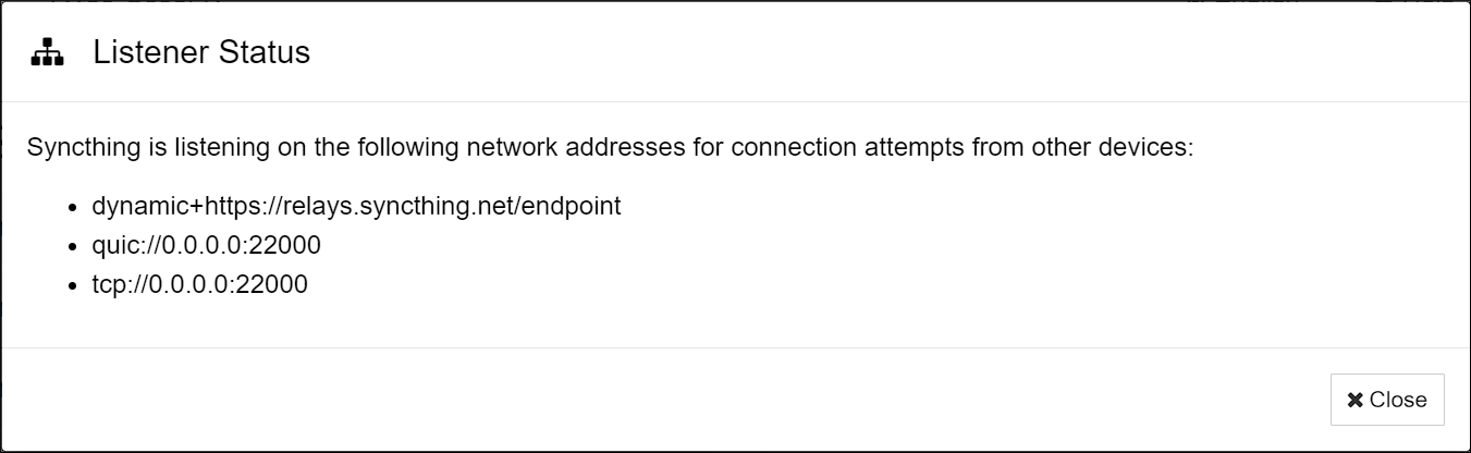

That means there’s either a firewall issue on the PC, or the PC isn’t listening on the correct interface or port. What listen address are you using on the PC?

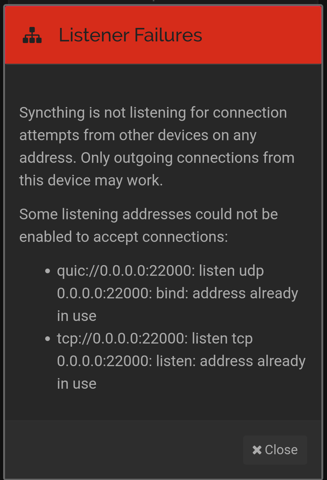

Looks like a crashed, stuck instance here. I would suggest to reboot the Android and see if that removes the errors. It’s probably not the root cause though.
It’s also possible that you’re trying to run syncthing-android and syncthing-fork at the same time: Don’t do that: They will conflict with each other. Choose one.

This is more or less what the situation in the GUI in relation to listeners and discovery with all settings at default should look on Android when running as root.

You’re right, I had both Syncthing and Syncthing-Fork running at the same time. Disabling Syncthing restored listeners to 2/2 green. (quic:// & tcp:// 0.0.0.0:22000)

Yes this is almost what I have, the difference between your screenshots and what I have on my phone is in discovery failures I have:
IPv4 local: write upd4 0.0.0.0:[randomport]>[destinationaddress*:21027]: sendto: operation not permitted
*Analysing traffic with NetworkTrafficView, I see that it’s the destination address shown here and not the source address which is the reserved DHCP address I gave the PC when following the workaround instructions which is slighlty different at the end
