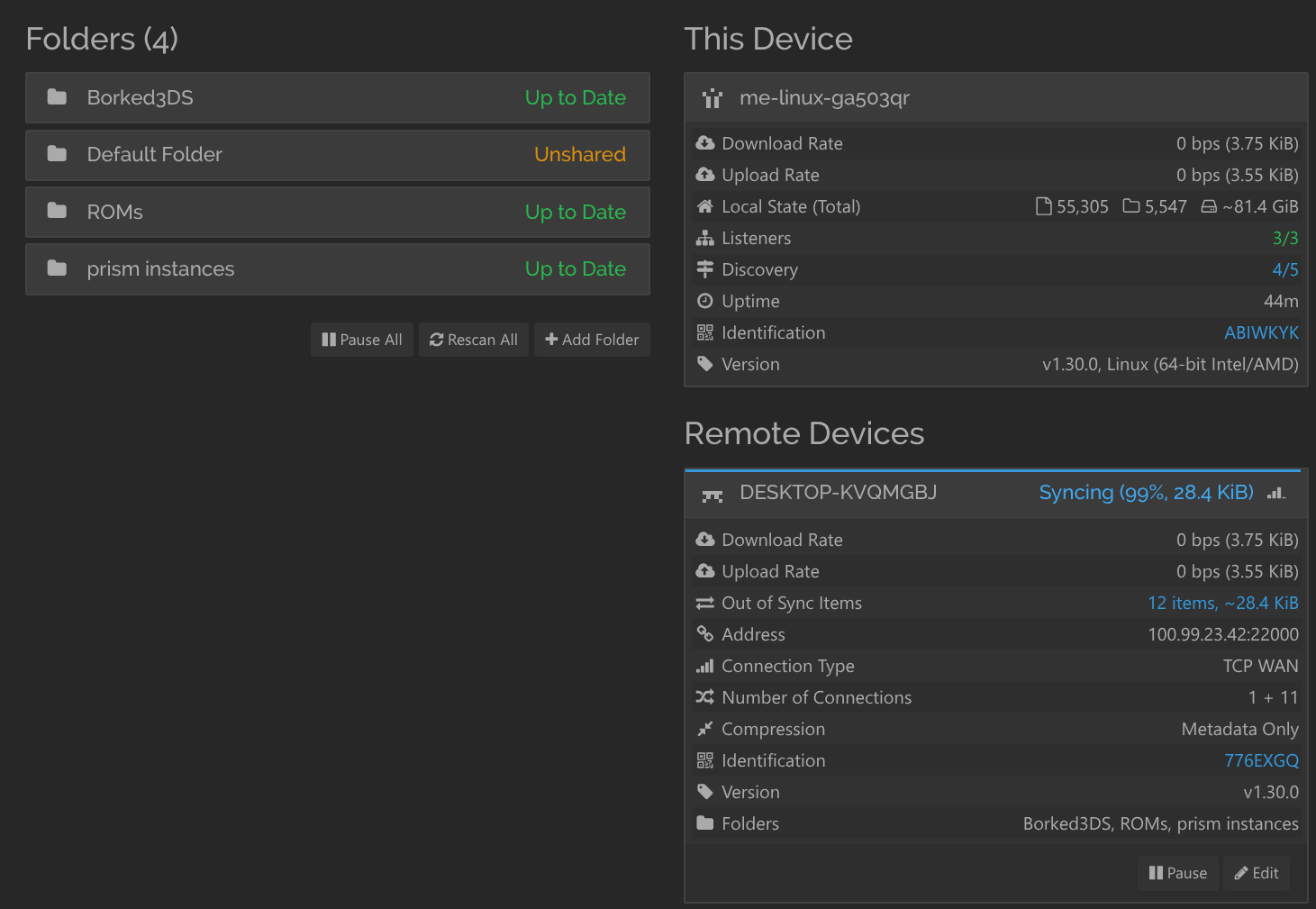

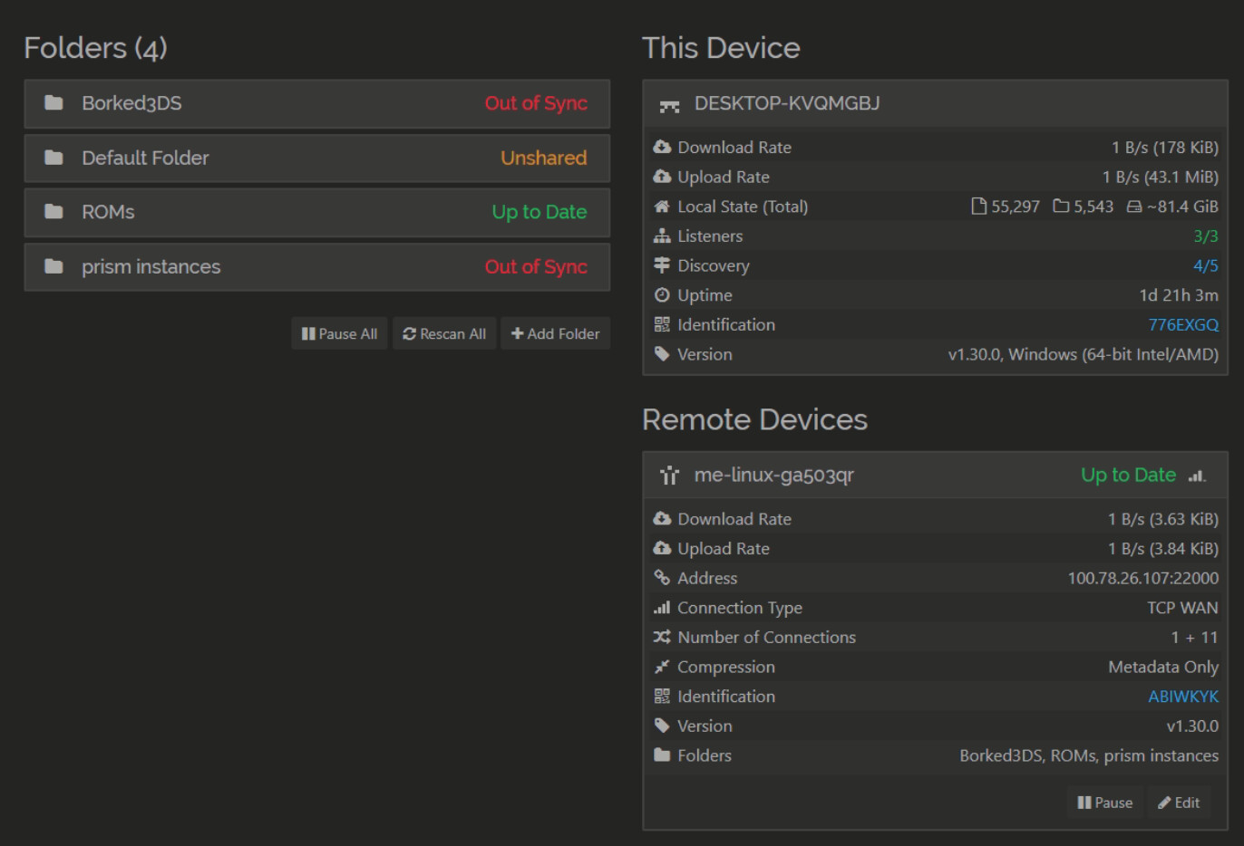

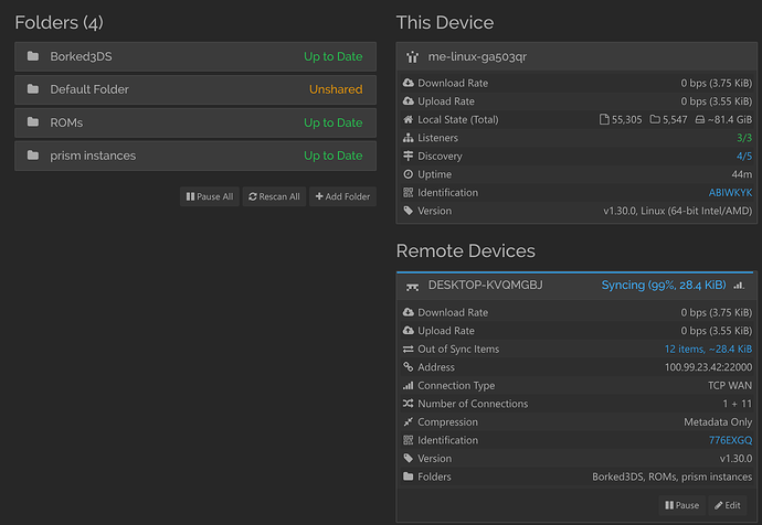

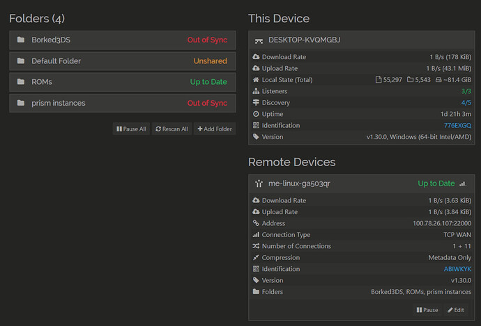

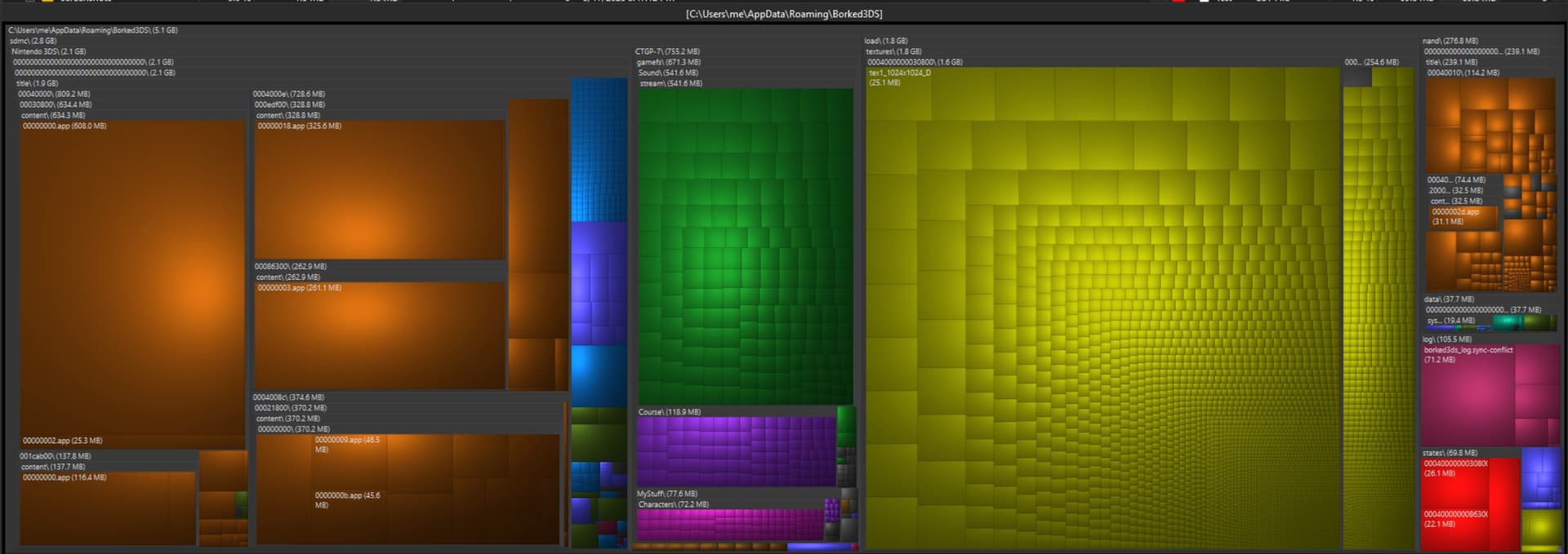

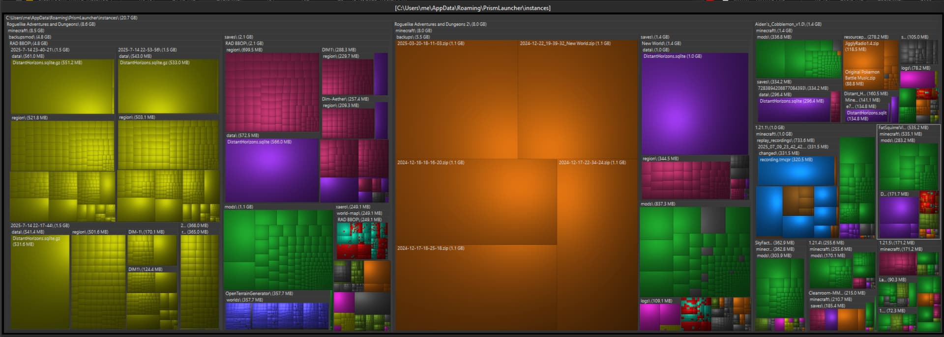

DESKTOP-KVQMGBJ has an AMD Ryzen 9 5900XT, 64 GiB of RAM at 3800 MT/s, and has some synced files on an SSD, and some on an HDD. All currently out-of-sync files are on its SSD. me-linux-ga503qr has an AMD Ryzen 9 5900HS, 16 GiB of RAM at 3200 MT/s, and has all synced files on an SSD. Below are screenshots of the two out-of-sync folders. Marcus, your theory makes sense to me. I’m not sure what the size next to the download/upload rates mean, but I’ve seen them get quite a bit higher than the size of the files that need to be synced, yet without any files seemingly being transferred.

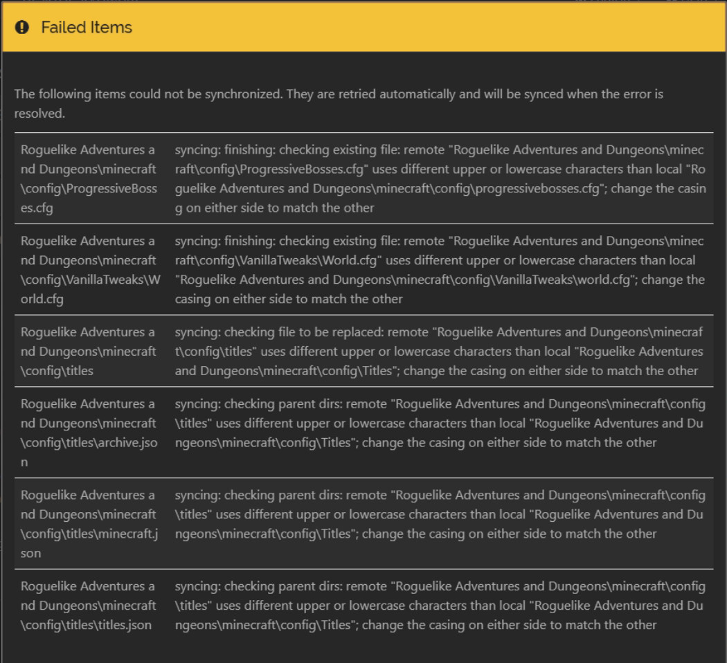

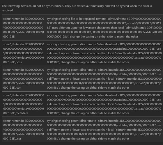

Could you post a screenshot of the files which haven’t been synced yet?
These are the “Out of Sync Items”, and (more importantly) “Failed Items”.
I have no idea how I never clicked on those. I’ll fix this now and report back.
All is well, files are now syncing at a brisk ~60 KiB/s. Thank you all!
