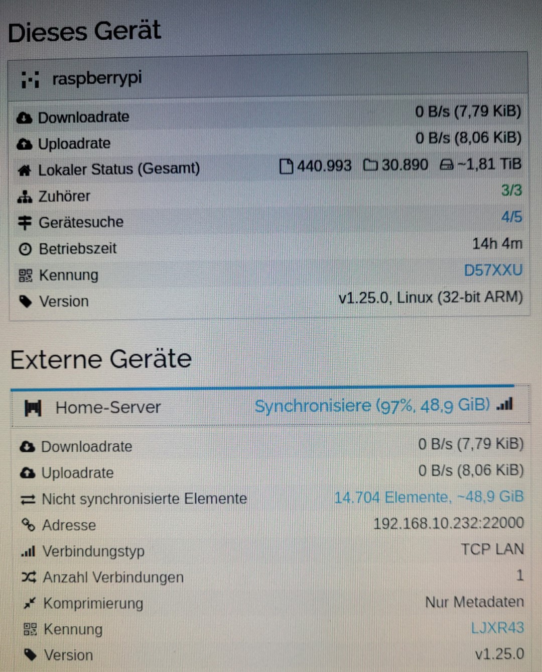

Hi, same on my side. In total 97% done and then syncthing stucks with 0 B/S.
This is the receiver (Openmediavault on VM Proxmox)
and this is the sender: Raspi 3b (Backup on USB HDD).
Sometimes I can see 1 B/S…

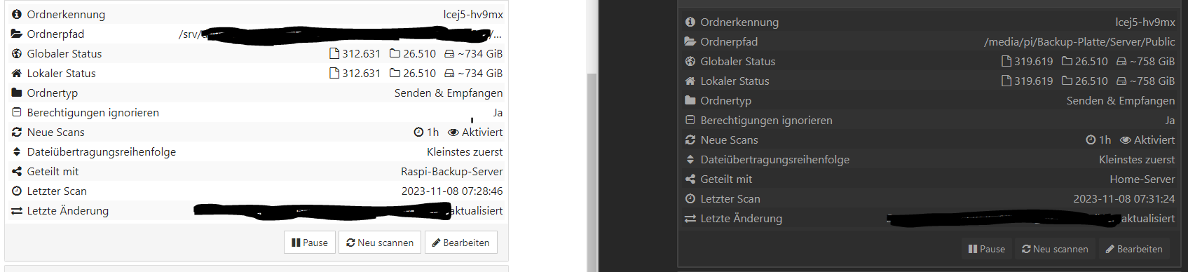

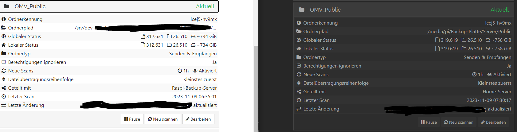

You should post a screenshot of folder statuses from both sides, not device statuses.
You’ve cut off the header of the folder that shows the status, so I have no idea what state they are in.
They both think they are in sync, even tho the file count dies not match.
Suggests you stop both instances, run syncthing --reset-deltas, and start them back up again.
Hi, thank you very much for your help. This was the solution. Now everything is fine.
