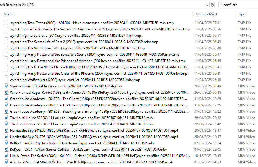

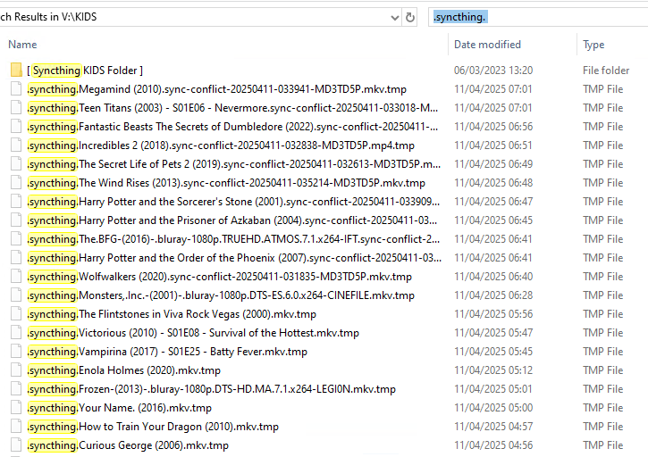

This process got me digging into the folders more closely and I discovered a lot of “sync-conflict” files. And also also “.tmp” files that are also “sync-conflict” files.

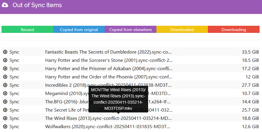

My current status is I have a Sync folder on two systems showing “Out of Sync” with 191GB of data that is Out of Sync. The TrueNAS system I need to delete the database again and hope I can get Syncthing to be stable again. However before I do this I am writing a script to delete all of the “.tmp” and “sync-conflict” files. The Out of Sync files are “sync-conflict” files only.
