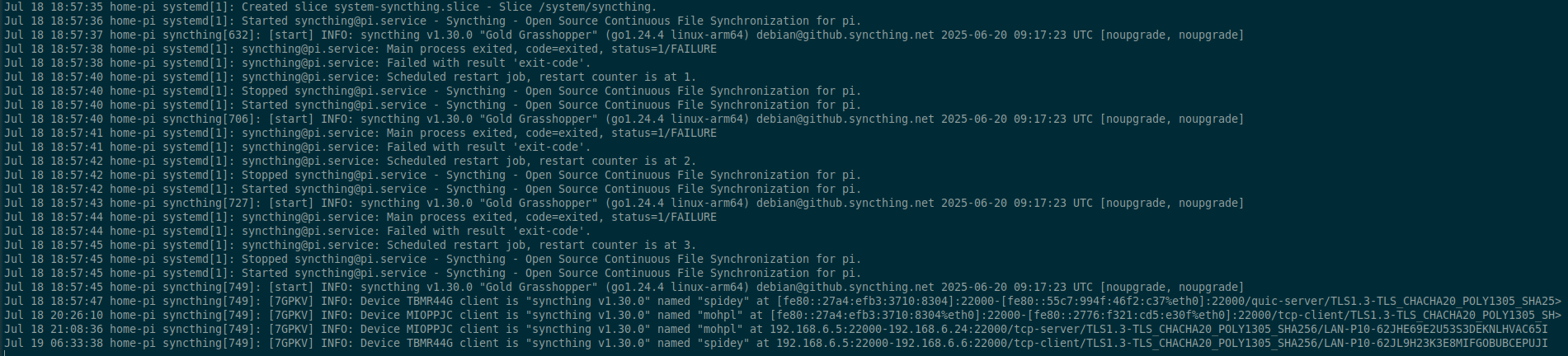

Need a way to figure out why syncthing fails a few times before succeeding at boot. Here is the pertinent journal logs:
This is happening before the syncthing logging facility is running as there is nothing in the logs from the GUI. If I add the line: ExecStartPre=/bin/sleep 9 under the Service heading it wait long enough for whatever it needs and it starts up the fist time. So how can I see what syncthing does not have if it starts up too early. I.E. what is causing these failures? Latest Raspberry pi OS.

I think you are on to something. I reexamined the logs closer. Just before the 4th success:
Jul 18 18:42:19 home-pi systemd[1]: Finished NetworkManager-wait-online.service - Network Manager Wait Online.
I will modify the systemd unit file to wait for that and see what happens.
Yes, in your log entries, Syncthing tries to bind to eth0…
… before eth0 has been assigned an IP address 8 seconds later:
