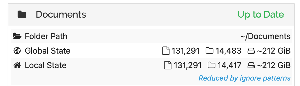

Also, how large is this folder exactly, and what device are you on? Can you provide a screenshot of the statistics page? For a folder with 82k files I get a spinner at the root level for about half a second at most, on an iPhone 15 Pro.

I can’t show you a screenshot of the statistics page because it makes the app freeze and crash every time I try to click on it :scream:
My folder is big at 131k files inside 14k directories, but apparently not so much compared to yours (~x1.6). My phone is a 13 mini. Not as powerful as yours, but again, not an order of magnitude weaker.
